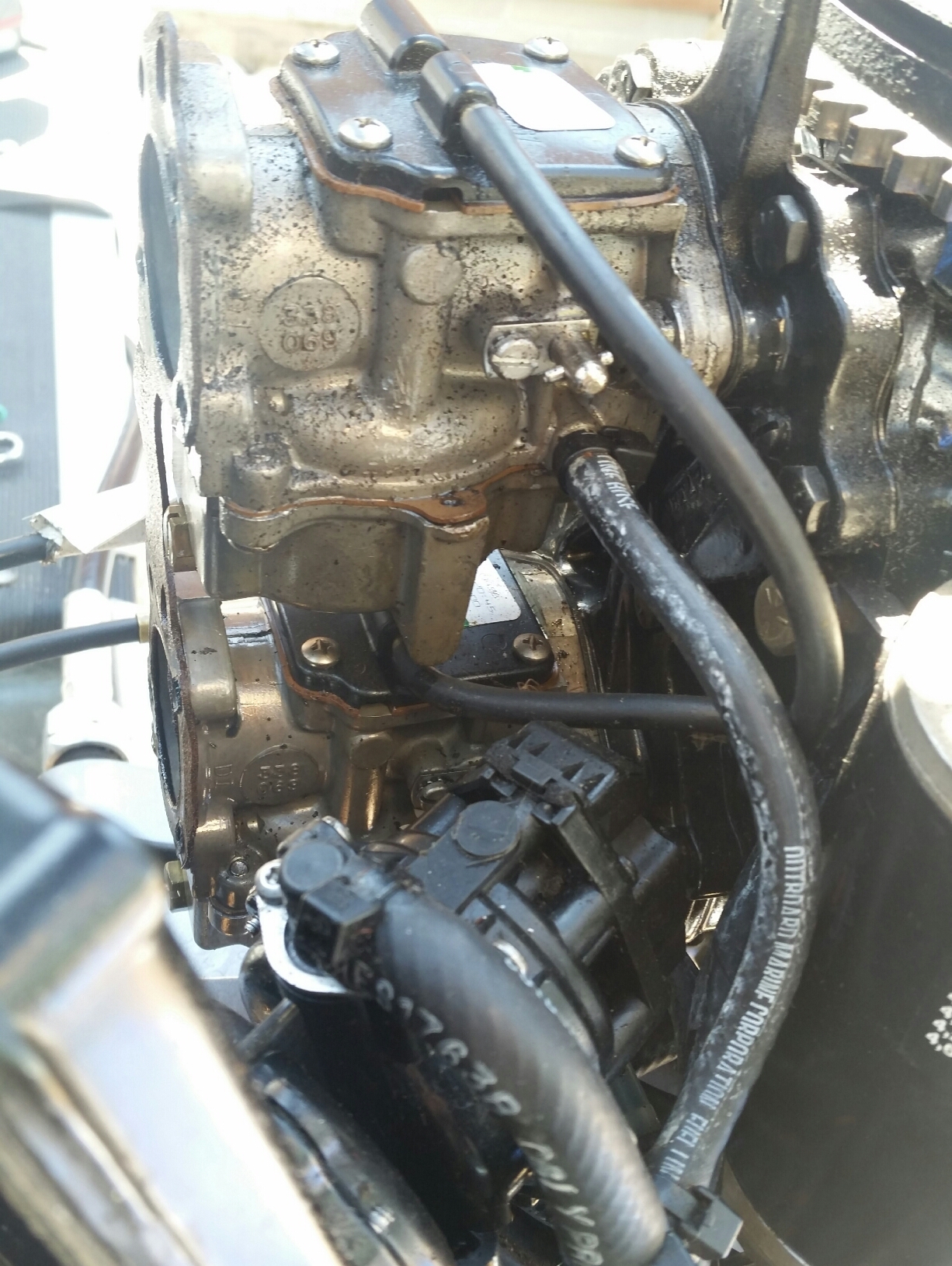

Getting the 'toon ready for the season & everything looks fine after winter storage. Except now the motor cranks & cranks but won't fire.
The fuel priming bulb is firm. There's fuel visible in the filter. I hear the "choke" click when I press in the key--but I suspect the choke solenoid might be bad.
I finally put a shot of ether in one cylinder and it started immediately & purred just fine. Next day I tried again... Same thing--crank crank crank crank forever. Finally started after 15 minutes of trying.
How do I troubleshoot this problem?
In the picture, is the small tube on the top of the carbs the "enrichment" lines?

Just to close this out...Yes the small hose connected to the top of the carb is the primer hose. It was getting no gas. I replaced the primer solenoid. Before putting it all back together I pumped up the bulb & jumpered the primer solenoid wire to the battery feed. The priming hose pissed gas 6 feet and continued until the pressure was gone from the bulb!
Now it fires right up.
