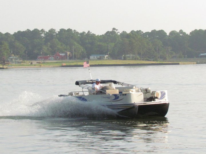

Enclosing pic of mine at 27 gps==moving lots of water!
