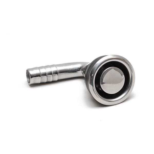

the tank should have a molded in barbed vent fitting that accepts a hose which gets clamped and runs (or ran) up to your original vented fuel fill system. sometimes the vented fuel fills don't work so well, and to eliminate it, you would install a separate fuel tank vent and either cap off the vent tube on your fill assembly, or change that out also to just a fuel fill without the vent tube. attached pics; the common vented fuel fill assembly; and just a separate fuel tank vent. it sounds like the dealer did some kind of rookie engineered vent, that may work based on design, but looks like crap, and the first time mud dobbers find that tube, there goes your fuel venting.
- fuel vent.jpg (22.22 KiB) Viewed 6969 times
- vented fuel fill.jpg (3.57 KiB) Viewed 6969 times
