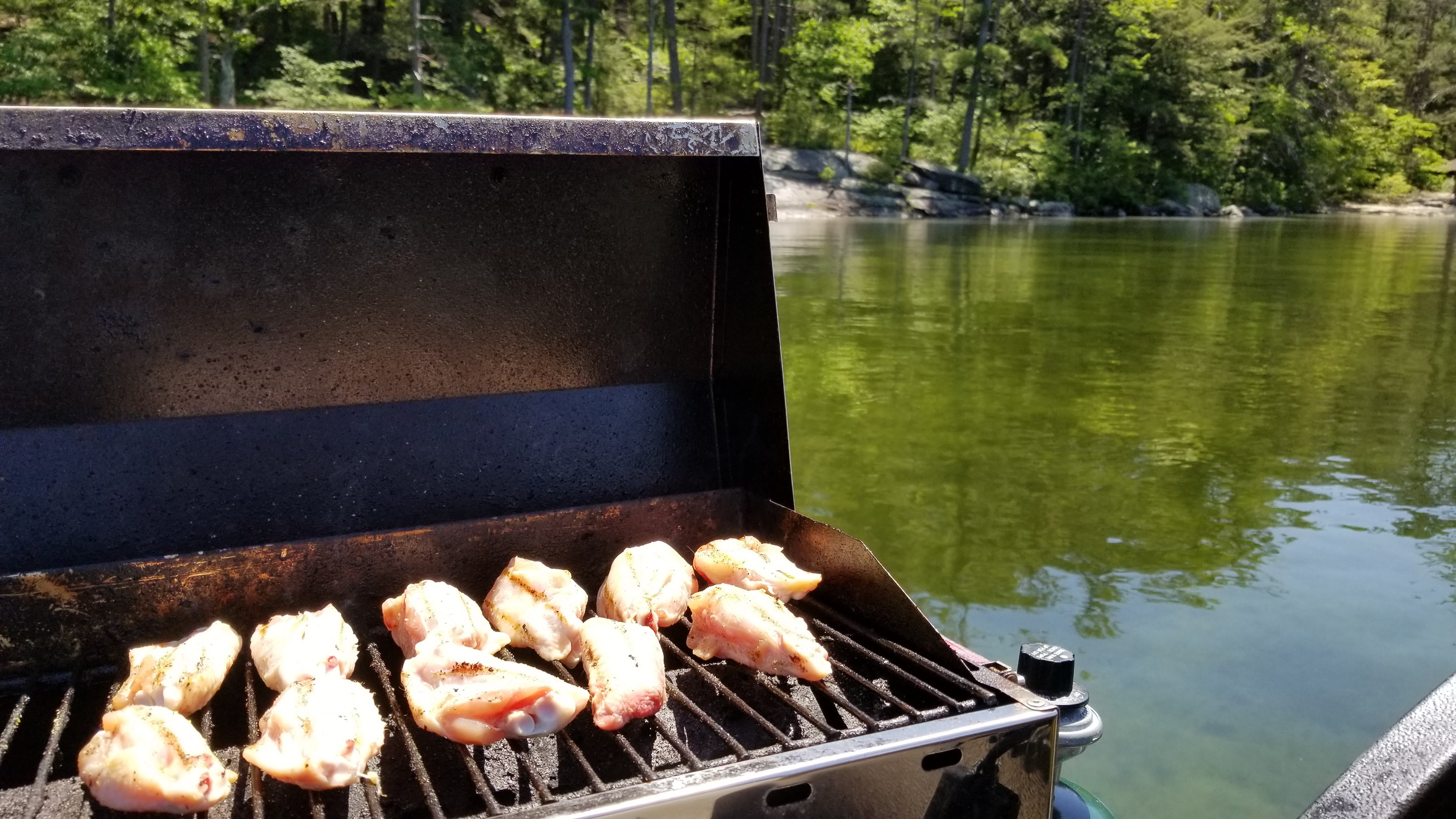

I know this is nothing unique, but our grill is our favorite part of our boat. There are quite of few boats on our lake that have grills, but I haven't seen any (for some strange reason) that have it permanently mounted on the rail like ours. I mount it in the spring and take it off in the fall. I bought a cover for a weber grill at Lowes that fits perfect so it's protected when not in use. It sure beats the years of cold sandwiches or going in from the water for lunch. I even pop popcorn for the kids (and me) on it.
We also turned our livewell into a "pantry" to store everything we need for grilling and eating like spices, plates, utensils etc..... Of course we bought the boat knowing we were going to use it this way. (I don't fish)

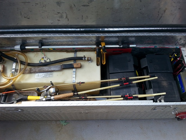

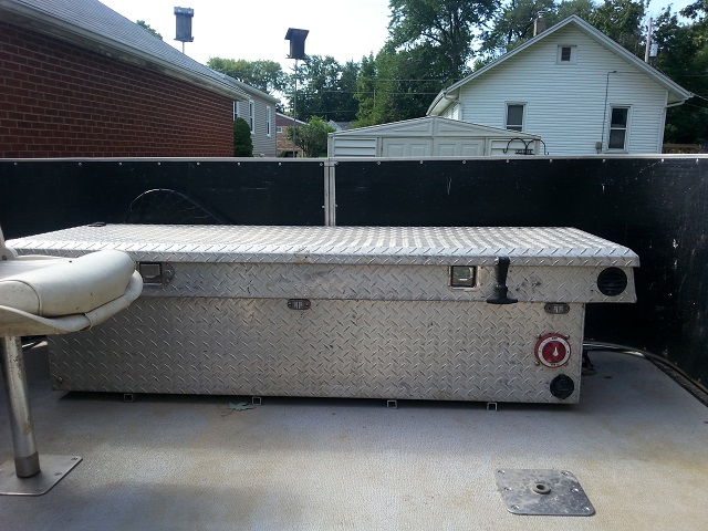

I only use my boat for cat fishing and hauling camping gear up and down the river. I only have a console and one seat. Every year something gets changed. In the past:
HDPE under skinning - Asian carp proof
Replaced railing panels with FRP - cheap and easy to replace
Floating dock hardware and poles on the front for anchoring
Flood lights on all four sides
This year I repurposed an old truck bed box for my gas tank, batteries, and tackle
Next year I'm planning on wrapping LED light strips on all four sides

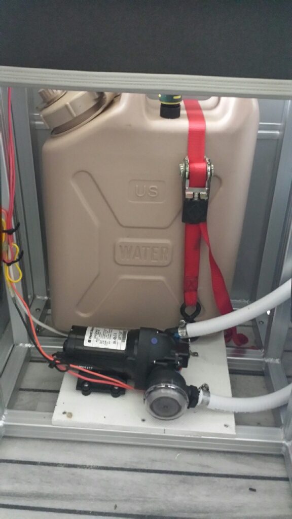

Several things, but most significant, Fresh water wash down system, and a custom bracket to mount my weber Baby Q grill in.

Nice water system setup. My Dealer wanted almost 700 to install one
Re: What have you done to make your boat special?
That’s what I’m talking about. I am really jealous of your boat. We use a setup similar to yours to fill wet cell batteries at work. I’m sure it can be built for about $50 or less.FLOUNDERPOUNDER225 wrote: ↑Wed Sep 05, 2018 7:15 amSeveral things, but most significant, Fresh water wash down system, and a custom bracket to mount my weber Baby Q grill in.
I don’t want to make potable water, but I would like to filter lake water for spraying down the deck. No storage that way. I want a 5 gallon water jug to refill my insulated cups.

Not $50 bucks, that is a Par Max jabsco 4.0 washdown pump, develops about 45 PSI, people use live well pumps which is ok to just run water, but if you want pressure you have to get a washdown pump. I had the Jerry Can laying around, so that was a freebee. If you want lake water, you could run a 1/2 inch hose under the deck to the stern, and mount to your bracket on the toon if you have one, put a screen around it to filter out debris, these pumps have a maximum lift of about 3 ft. so you would need to measure vertically from the pump to the pick up point.Henpecked wrote: ↑Wed Sep 05, 2018 9:04 amThat’s what I’m talking about. I am really jealous of your boat. We use a setup similar to yours to fill wet cell batteries at work. I’m sure it can be built for about $50 or less.FLOUNDERPOUNDER225 wrote: ↑Wed Sep 05, 2018 7:15 amSeveral things, but most significant, Fresh water wash down system, and a custom bracket to mount my weber Baby Q grill in.

I’m not sure what pump we use or if it’s submersible. I don’t know the psi either, but water comes out like a bathroom faucet and it runs on 12VDC. I’ll have to ask my coworker who built the watering cart. We pump water into batteries 12 ft up on racks like nothing.
I found the pump we use at Northern Tool for $89. Self priming, in line, 40 foot head max, 340GPH. It pulls 15 amps, but it won’t need to be turned on for very long at a time. I figure about $120 by the time I get it mounted, wired and plumbed.
