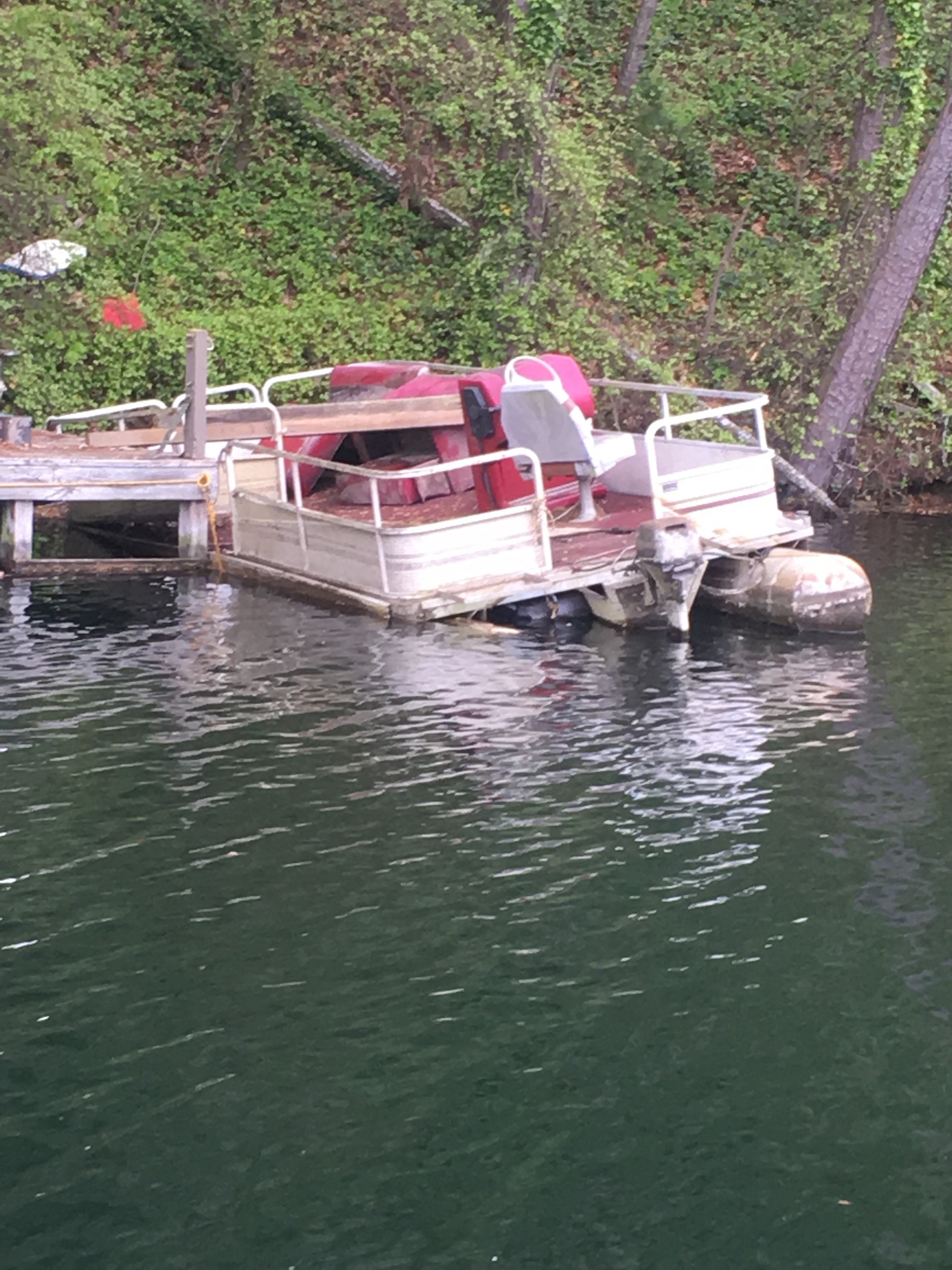

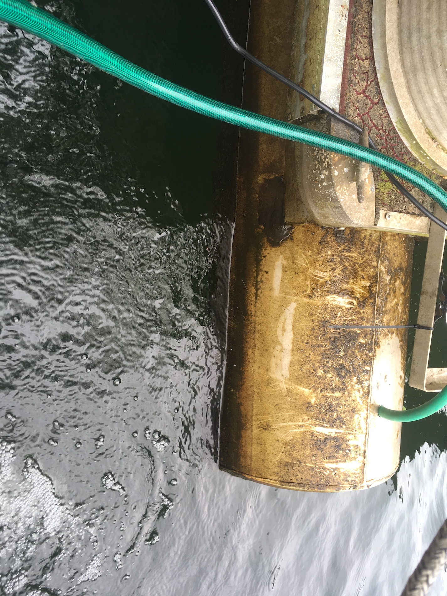

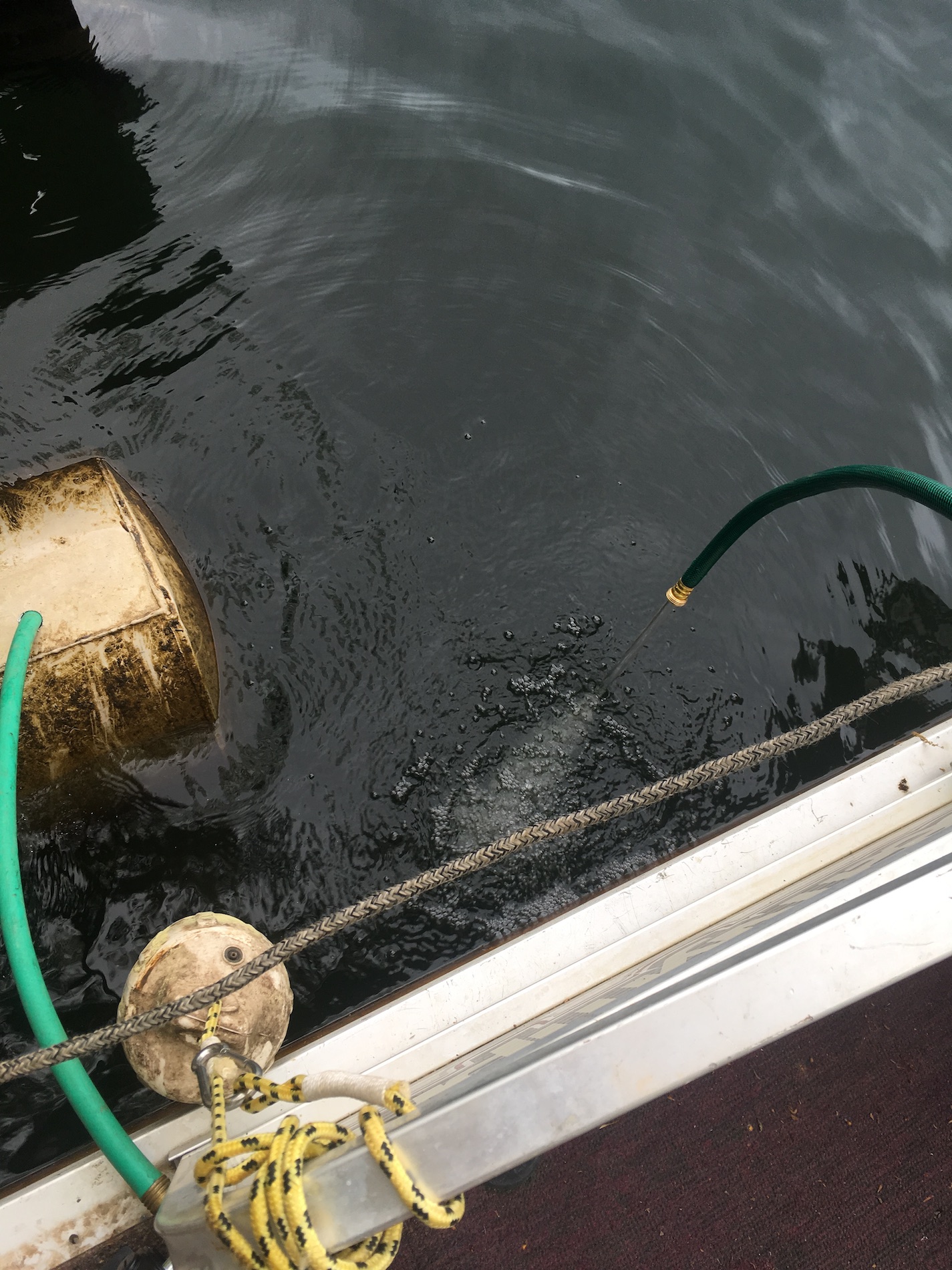

Sorry for the delay. Initially the boat was completely submerged on one side with a water line running down the center of the boat. The motor was completely under water. So it was tilting at around 45 degrees.

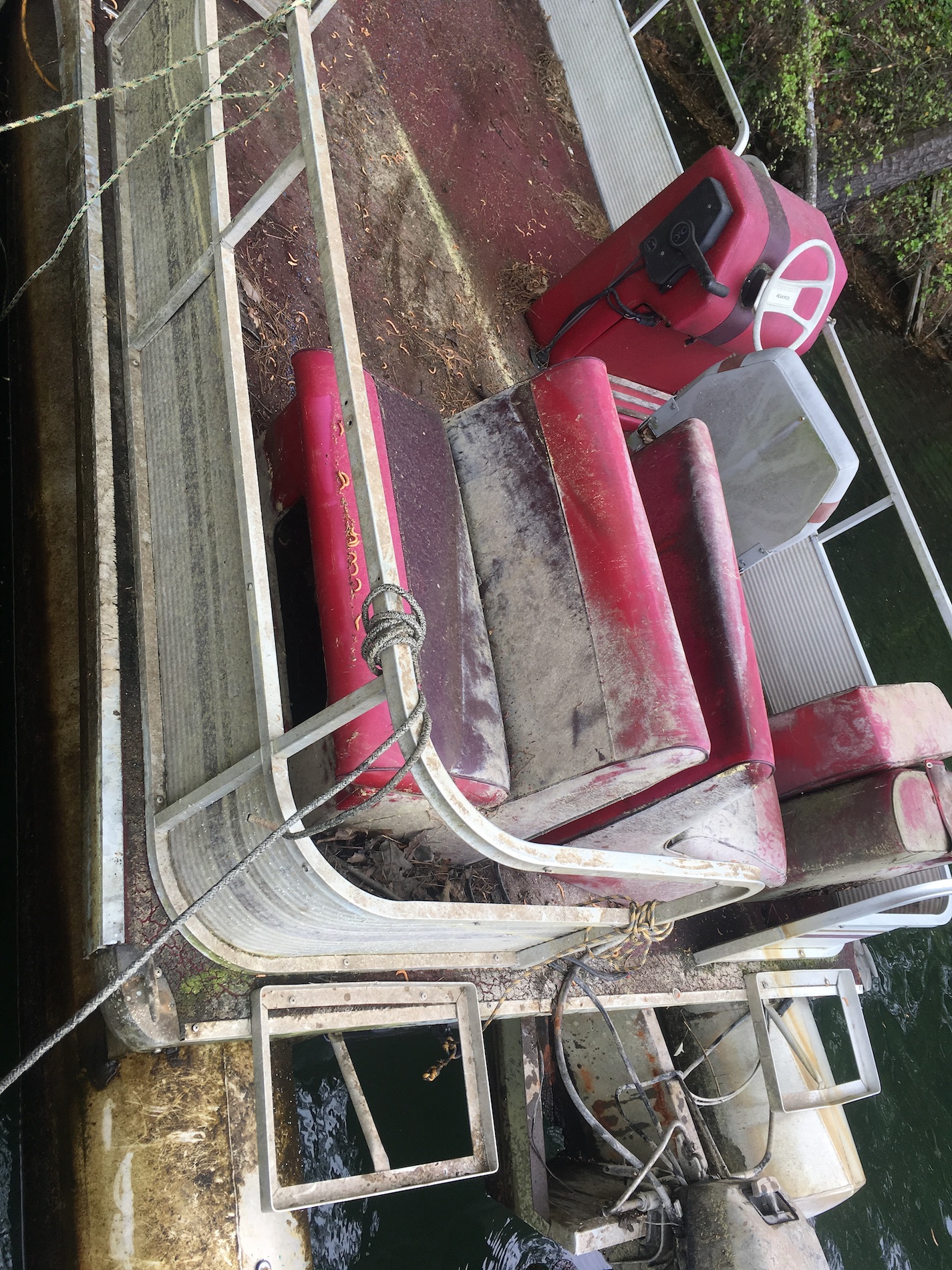

We moved all the water soaked benches to the good pontoon side of the boat.
I mounted a 4x4 to the side of the dock to get some height for my come-along. Ratcheted it up to where the top of the sunken pontoon could be accessed.
Shoved 2 Jetski float cubes under the tail end. (these had little or no effect)

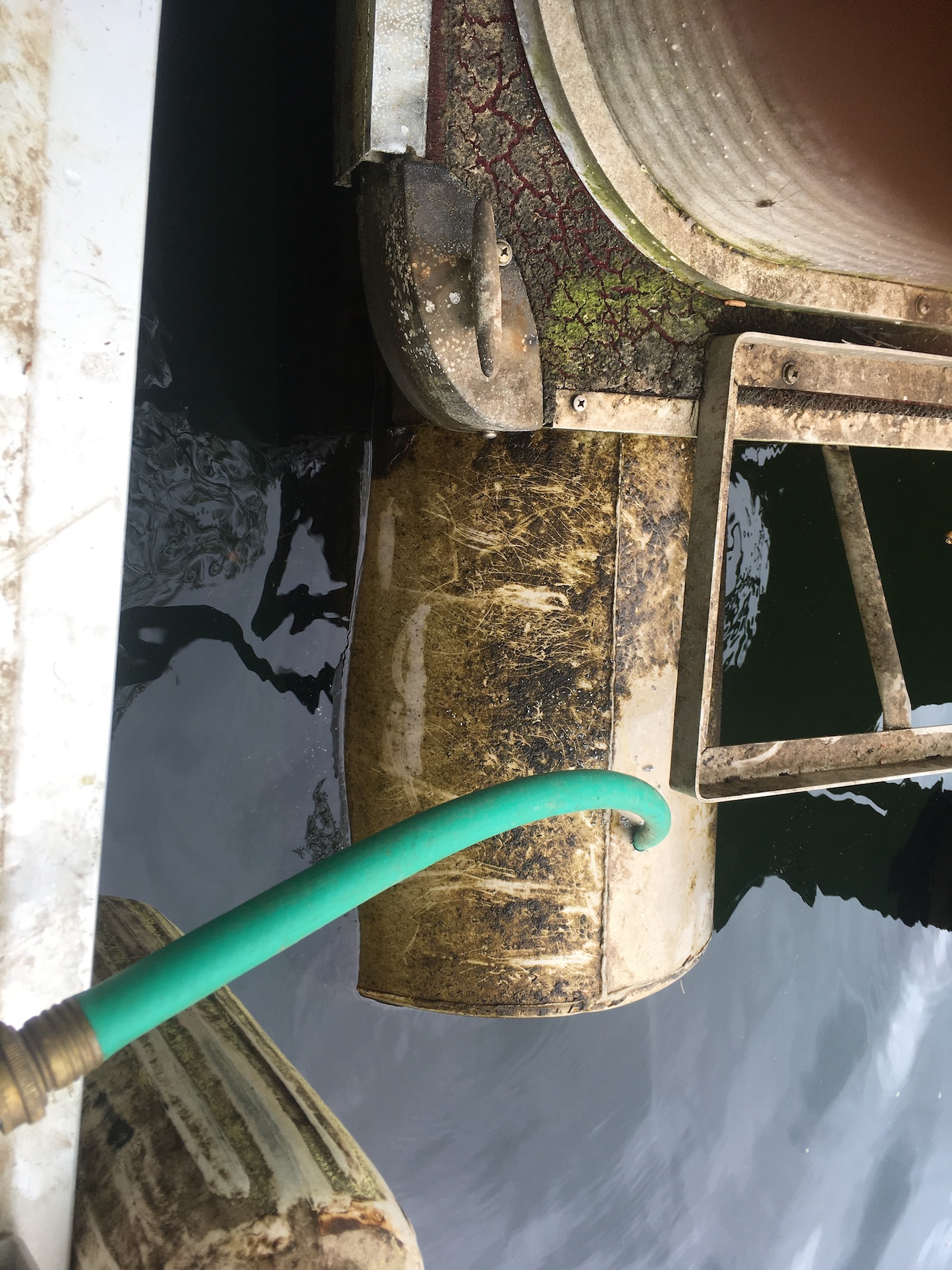

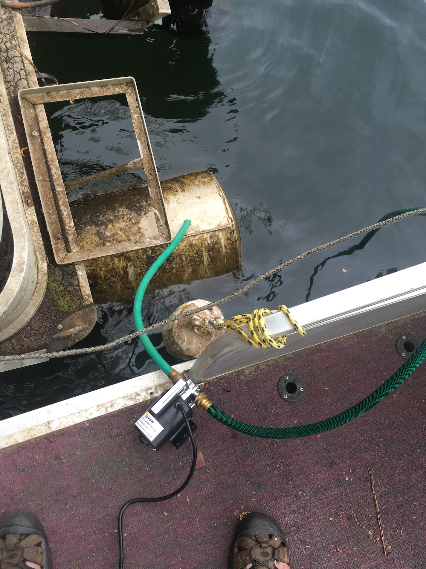

Drilled a 7/8 inch hole in the top of tail section. Then fed a garden hose down into it. The short hose was attached to an electric pump that pumps 330 gallons of water an hour.
Hooked it up to a small Honda generator and ran the pump. It took 1.5 hours to remove all the water in the pontoon.
The pontoon slowly righted itself and with the help of the 2 Jetski cubes. I marked with my finger the water line as it began to rise. When all the water was out plugged the hole with a rubber lever type expandable plug.
It has remained upright since then. All went as planned.
Next to the boat ramp to a trailer and to be repaired.

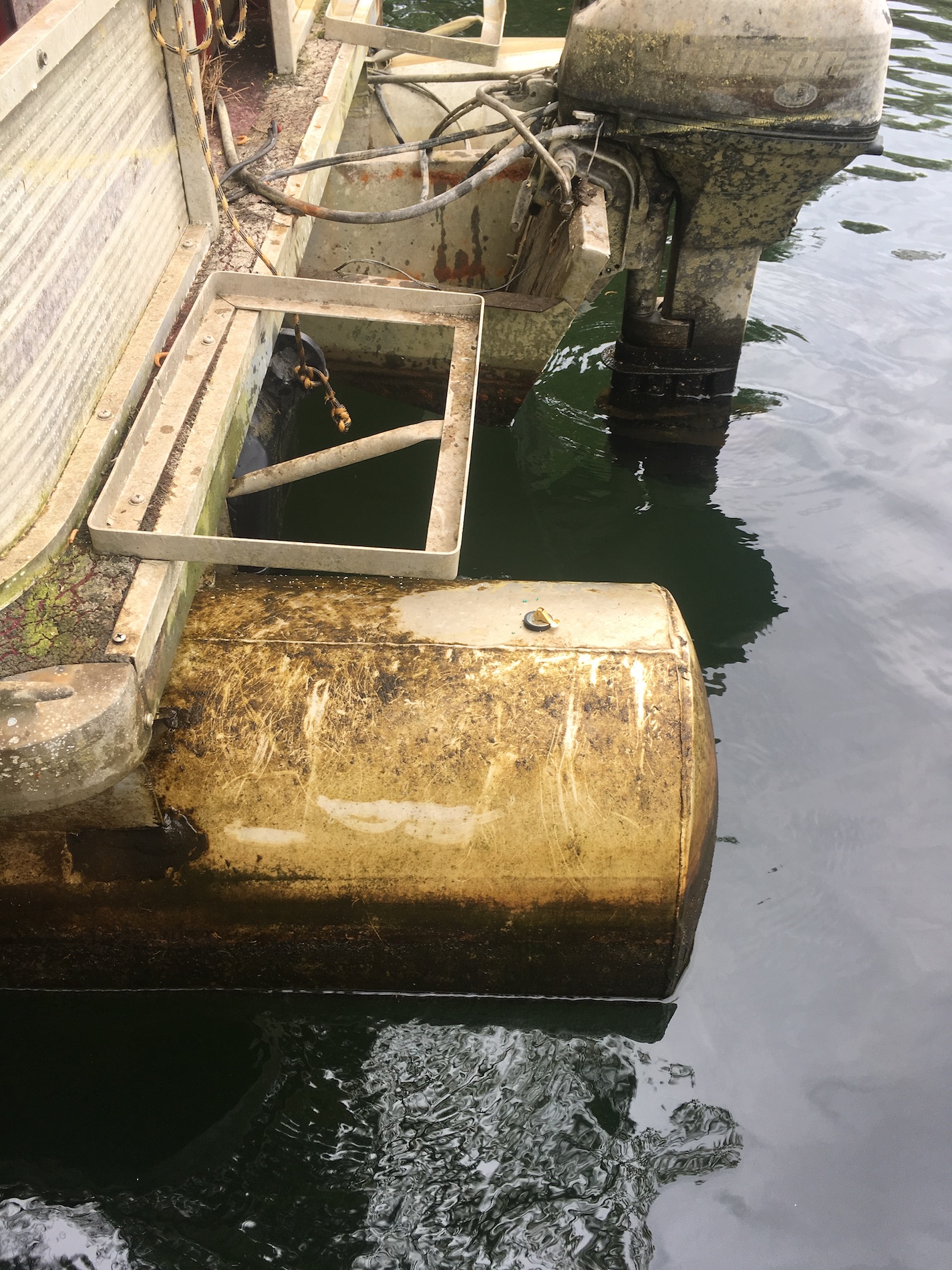

- You can see where the waterline was
- IMG_1698.jpg (1.06 MiB) Viewed 8441 times

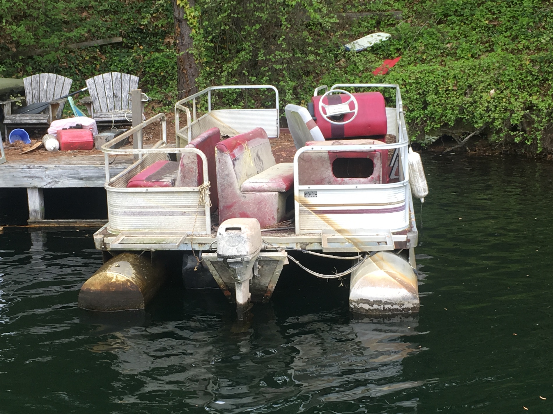

- You can really see the water line here across the back of the boat.
- IMG_1701.jpg (816.28 KiB) Viewed 8441 times
