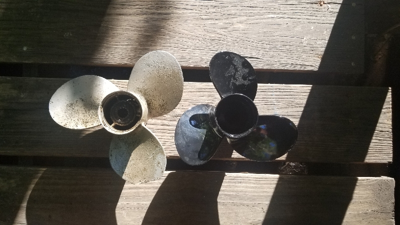

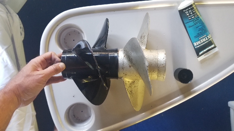

So new prop arrived today!!! I just came back from installing it. I didn't take it for a drive today, going to do that tomorrow, but there will be a difference. Take a look...the silver one is the one that was on the motor when I got it:
I couldn't get the numbers off the old prop, it was way too pitted so I have no idea the pitch.- Attachments

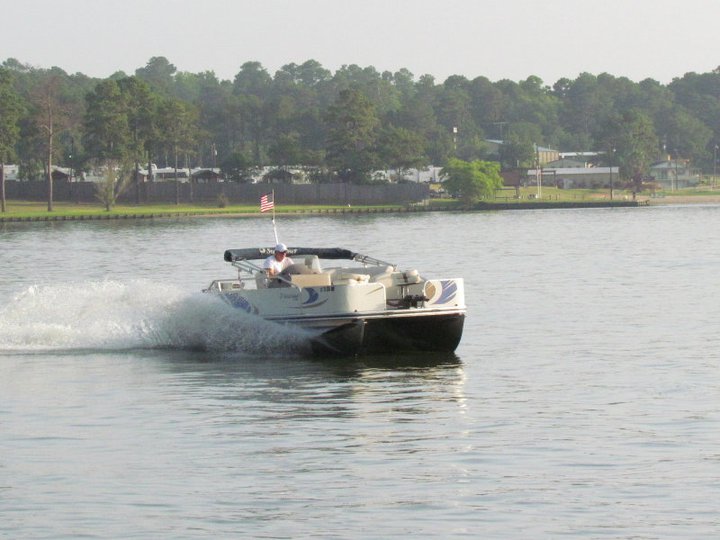

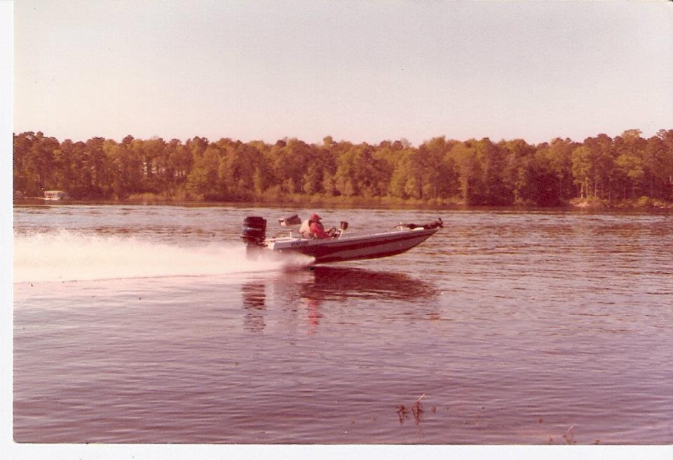

Here's a couple pics that show how much water a toon displaces. Mine is a 20 ft Lowe with a 90 Merc Optimax. I'm running 27 in this pic. Am actually trimmed out quite a bit and turning 57-5800... In comparison-my 1979 Venture with a 115.. Running 56 in this pic. 1980 Toledo Bend Tx. A Pontoon is like pushing a dumpster thru the water...
I'm running a 13x16 pitch SS prop... Strangely with a Merc 13x 16 aluminum prop I will run 28-29 Go figure.
