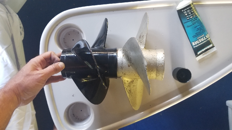

So new prop arrived today!!! I just came back from installing it. I didn't take it for a drive today, going to do that tomorrow, but there will be a difference. Take a look...the silver one is the one that was on the motor when I got it:
I couldn't get the numbers off the old prop, it was way too pitted so I have no idea the pitch.

Well I was able to take the pontoon out twice this weekend...so with 3 adults and one teenager the pontoon was able to hit 17mph and right at 5000rpm. to say I am happy would be an understatement. before the prop change 12mph maybe 13 if the conditions were just right was the most I could get plus WOT was 1000+ rpms too high.
