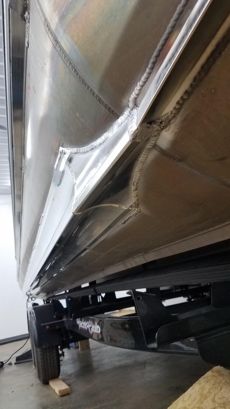

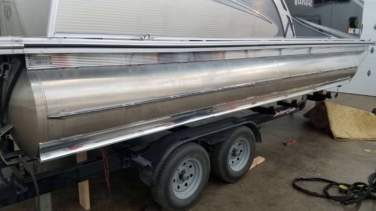

Strakes are going on! Well to be fair my boat already had 4 these are just on the outside of the outer toons. I bought my boat as a demo and it didn't have all the options I wanted but for the price it was worth adding things after.
My boat now has the Tahoe/Avalon wave glider package (except my fuel tank is a few gallons smaller) and I'm beyond excited. Only one side is added so far but my friend just sent me these pictures.
I traded him boats the other evening. My toon is in his shop and his bass boat is in mine lol. He's a master fabricator and this is a walk in the park for him. Once I get it back home the logs are getting painted. The polished risers, side keels, and new strakes will look great against gloss black metallic paint!

Tell your buddy he sucks....because he missed at least 2 dimes in that stack :P
Looks great, did he make the strakes or is it an off the shelf item? :thumbsup

I take it the 3M tape wasn't going to be strong enough to hold them on? :lol3
Looks great...I look forward to see the video of them in action.

Those strakes are matching OEM from Tahoe/Avalon. I ordered them last summer and it took forever for them to show up. I got them at the end of the season last year. It's way, way, way cheaper to have your own made ( what I did on my last custom build) , but they needed to match. We spent enough on this boat I want it to look like it's supposed to! Only a fabricator would know these are not original. They are tig welded vs. the factory mig job.

Your friend does some damn nice work!
