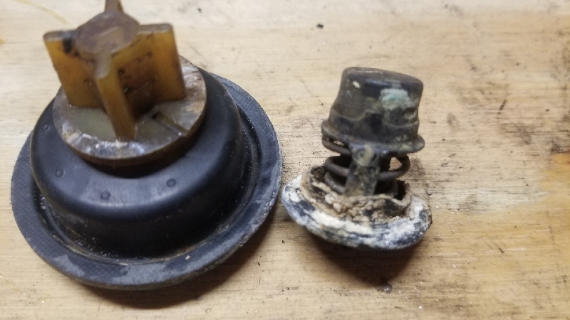

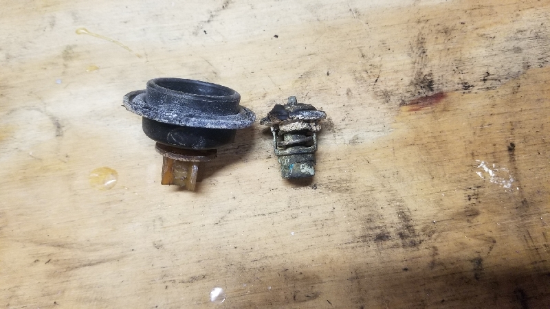

So really the only thing I haven't replaced on my 60hp Mercury motor is the thermostat (and the reeds). So I ordered my kit and installed it the other day. I would say it was time:
Now since doing that i noticed the water coming out the tell tale is much, much warmer then what it used to be, I'm guessing that's good cause it's removing the heat from the block? I never did have an overheat issue with the old thermostat so I guess we'll see how it works. I'm taking the pontoon out Friday to run it.

Oh I think you could have gotten another 15 minutes or so outta that one! :biggrin2 :rofl

I got a whole year out of it!! and who knows how long before I got the boat. I'll be upset if the motor doesn't work so well after replacing it :lol3
