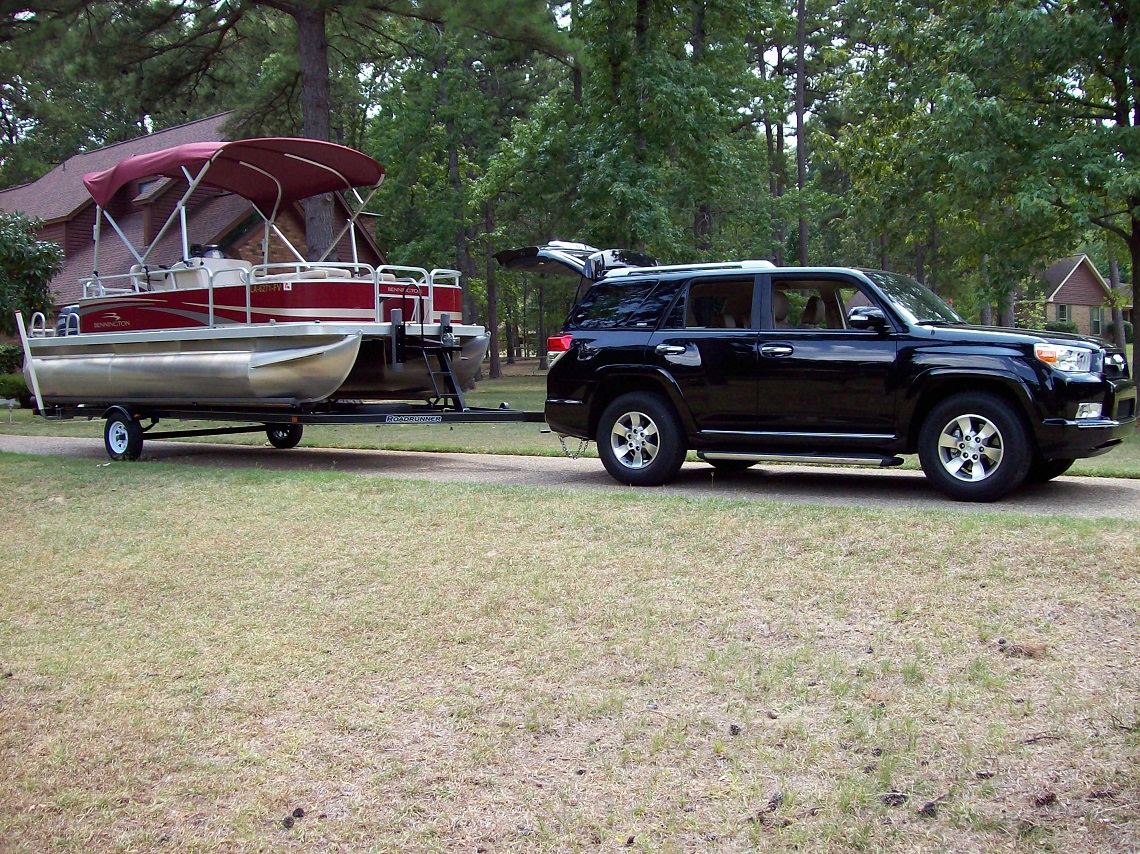

Hello DHO.... just to give you some perspective, I have a Bennington 20 footer / 25 inch tubes / 75 horse yamaha... I think once I calculated the weight of the boat, motor and trailer at around 2900 lbs, and that didn't include any gear or fuel, which weighs around 6 pounds a gallon, so if you're hauling 20 gallons you can add approx. another 120 lbs.. anyway I pull my boat with an older Toyota 4 Runner with a 4.0 V6. It's rated to pull 5000 lbs, and it pulls it just fine, but I won't lie, going up steep inclines, I can feel that benny back there.
- 100_1153.JPG (703.85 KiB) Viewed 15454 times
