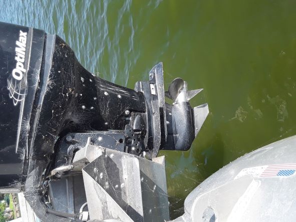

I have a 20 ft Lowe with a 90 Merc Optimax-25" tubes. SS prop 13x16 pitch. Fishing model with fishing seats up front. No couches.
I run 27 by myself. 28 with my aluminum prop-same pitch--go figure. I have no cavitation problems. I can trim it out a long way before it breaks loose. When rig was new in 2009 I hit 29 once in early spring when water was cold.
I'm set up with my cavitation plate maybe an inch or less below the engine mounting pod. You may need to raise your engine. Too low in water and lower unit disturbs the flow of water around the prop and it blows out--sorta like stalling a wing on an airplane. Good luck.

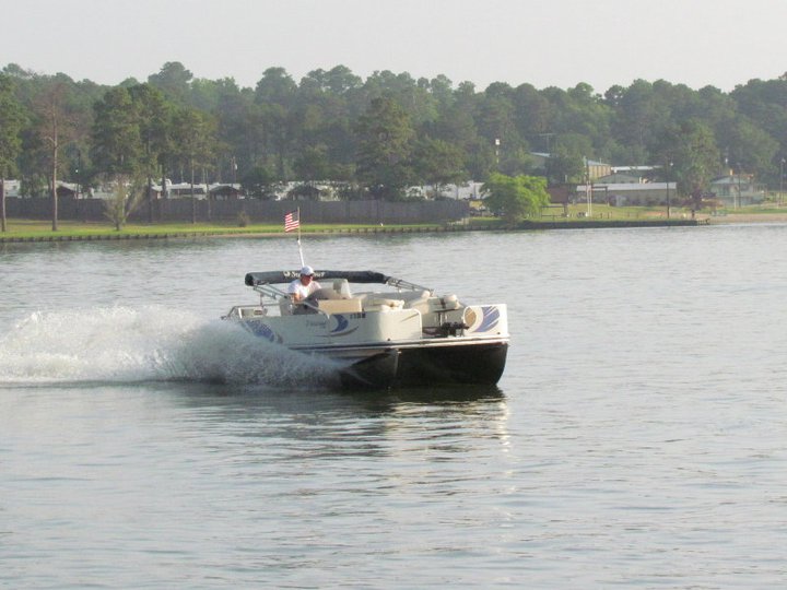

I thought you had a long shaft lower unit so thought cav plate was too deep. Best thing to do is to get a video of you running WOT so you can see what the water flow looks like around the motor. Shoot from side of boat and behind the boat ...Good luck...
Enclosing pic of me running 27--throwing a lot of water.
