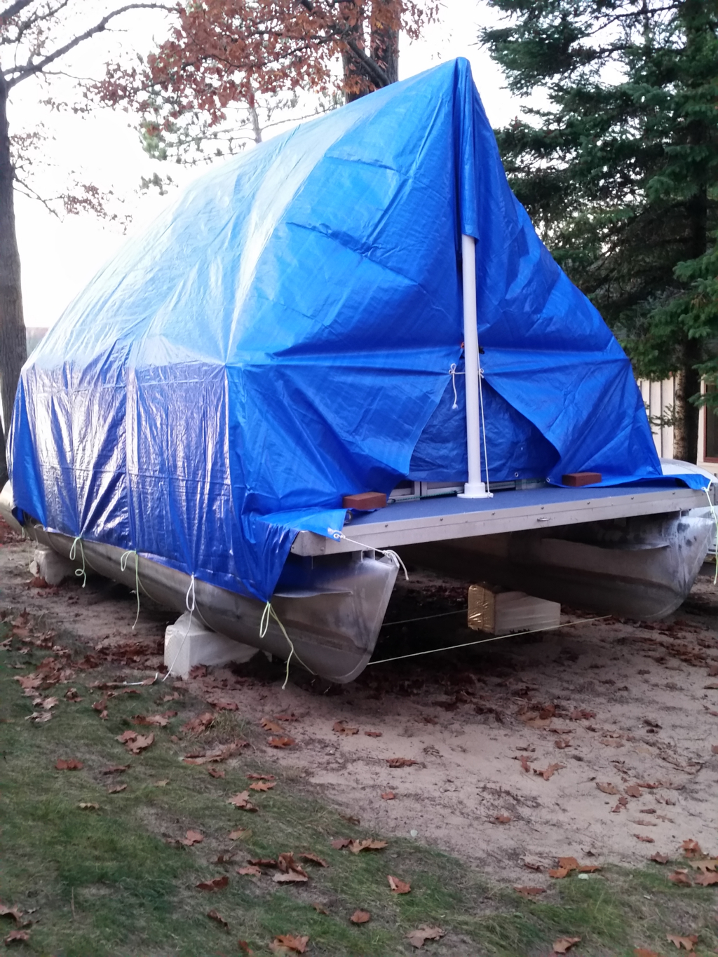

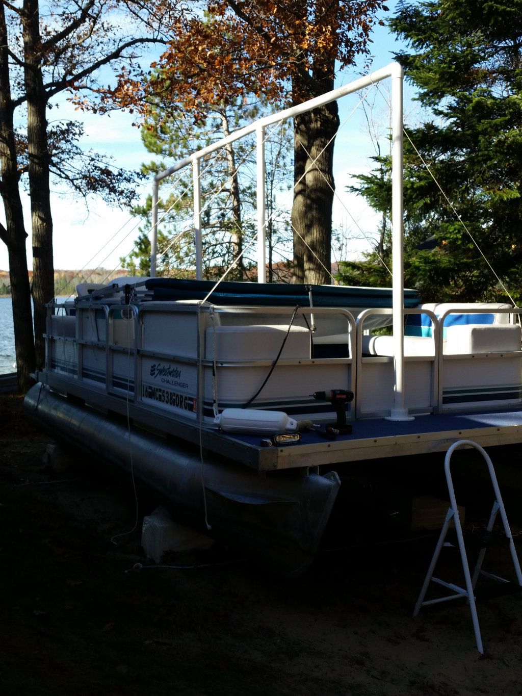

None of these answers addresses snow build up for winter storage. Every year I see covers like this caved in with the weight of the snow & water doing significant damage to the seats & console.
The OP has the right idea to build a tall PVC frame with a pitch that snow will slide off of.
If you go by storage lots where people have their pontoons shrink-wrapped & parked until spring you'll get a good idea what you should aim for in height & angles.

#8 Post by guy48065 » Fri May 27, 2022 11:57 am
You don't have this issue in SC.
https://www.iboats.com/shop/navigloo-bo ... zIQAvD_BwE
I haven't found it necessary to use solid "rafters". I've been using ¼" rope but I plan to replace them with 1" ratchet straps to make adjustments easier.
I store the ridge pole in my garage up in the rafters & keep the legs in the corner.
Unfortunately I hear pvc has skyrocketed lately. Thanks Joe.
Mark
