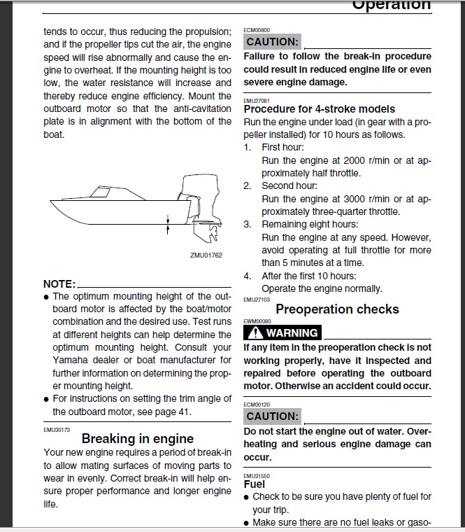

Hey guys, I have a couple of questions that I can only term as stupid questions, but none the less I don't know the answers so I would love to hear from some of you guys with pontoon experience under your belt. The first is on engine break in. I recently purchased a 20' Bennington fishing barge with a 75 hp yamaha 4 stroke. I keep getting conflicting reports on "how" to break it in. I know there's a manual on the boat, but the boats in storeage with the cover on it so right now it's not around. My son said when he bought his 115 yamaha he was told to not go over half throttle for the first 2 hours, then from 2 to ten hours he could run it up to 3/4 throttle, but not to leave it there, to vary the speeds, after ten hours, let her rip... Your thoughts on this... and the other question I have almost embarasses me to ask, but then again, never owned a boat before so here goes.... how to you operate the bilge on the boat? Theres a switch on the dash, and I'm assuming flipping that swith will start to fill the live well, but does it automatically shut off or do you have to watch it and shut it off before it fills too much, then how do you drain it. Sorry for asking such novice questions, but hey, if you don't know, the only way to find out is to ask. Thanks in advance for your help.

This is from Yamaha's outboard online manuals Link Here: http://www.yamaha-motor.com/outboard/se ... s=outboard But I think break in suggestions remain the same for all at least 4 stroke motors.

Hey guys, thanks for the respose. I really appreciate it. I'm going to down load the manual with the link that was provided for the yamaha web site. I've got less than 2 hours on the motor and it's never been over 1/2 throttle so I'm good there.. as for the bilge pump question, I looked in the live well and yes, there is a piece of pvc sticking up. so that leads me to a follow up question. I believe there is a 2 position switch on the console for the bilge.. manual and auto, I'd assume the auto shuts the bilge off at overflow. since the pvc tube is also the drain, do you just grab the tube and pull it straight up or are they normally threaded and have to twist /turn to drain?
