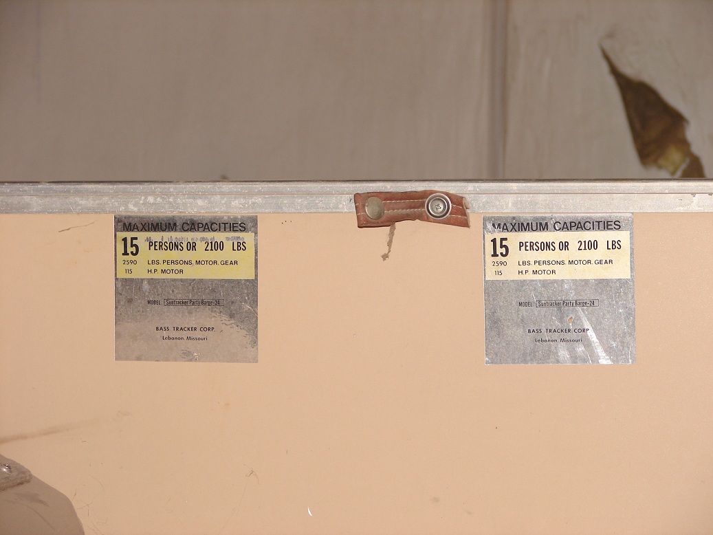

here is the tag on my 83 Party barge...well it currently has a 75 and you can see the tag claims upto a 115. do you think if i found a deal on a 150 i would be ok or do not dare think about going over the 115hp

Several things come into play, one and probably for most is the water police. If they pull you over for some reason, even just a routine safety check, and look at the plate and your overpowered, it's big ticket time. Second your Insurance company won't be happy if you have to make a liability claim and they find out your over powered, they will just wave Bye Bye to you. I know this isn't what you wanted to hear probably. More info on your toon would help! I would never suggest such a sneaky thing, but I know of a few guys who replaced the motor decals with the appropriate one they wanted. Your really rolling the dice if you do that!

I agree, it isn't worth the trouble not to mention personal liability in case of accident.

Well, you may indeed incounter structural problems seeing that the toon was only built to take the weight and torque of a 115....
I wouldnt put more then a 115 on it. Youll certainly beat 16 mph with a 115.

I agree...the hull is designed for 115 or under. Go over that and you will have problems structurally, and in the case of an accident, legally.

Go with a 115 HO E-TEC. That will keep you within the plate specs and still give you about 130 hp plus you will have a super motor.
