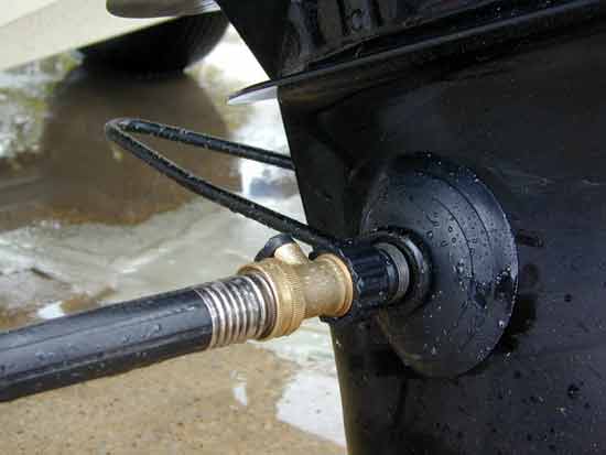

I dont have the savers. As for ear muffs. That is an attachment that goes on the garden hose to run your engine in the yard or to flush out saltwater. Goes over the lowerunit ate the cooling intake.

Trott and Rcl700, thanks so much for the quick replys. As for the transom saver, I don't think they're very expensive so I'll probably get one this weekend.. with regard to the "earmuffs". I must have missed something when my boat salesman went over the "hooking up the hose to my motor " lesson. As I understood it, there's a line with a plastic coupling that I can just unscrew, and then attach a water hose so that I can start my motor out of the water... He never mentioned anything like the ear muffs that you pictured. :donno Wonder why he never mentioned that? oh well, thanks again guys.. I really appreciate it.

Roland, The transom saver is a good idea. All Sun Tracker trailers now come with them and they will not warrant their motor pod welds if they are not used. You do need the muffs if you run the motor out of water. The hose attachment built into the motor is only for flushing the motor after saltwater use.

From the Mercury Oweners Manual concerning flushing with a water hose .....
Page 60 - "IMPORTANT: The engine must be run during flushing in order to open the thermostat and circulate water through the water passages."
Page 61 - "IMPORTANT: Do not run the engine above idle when flushing."
The complete procedure for flushing is listed on these pages.

I was informed by my bennington dealer that that hose hookup is a backflush and NOT to run the motor with the hose hooked up to that port. he said that you would endup hydrolocking the motor.
now that i said that I have pretty much the same boat same motor that is for sure. it is in the manual how to flush the motor. ear muffs are cheap just pick up a pair every boat owner should have one. they are nice for flushing not only salt water but sand. also if you do use the flush port dont use to much pressure you could blow some seals.
