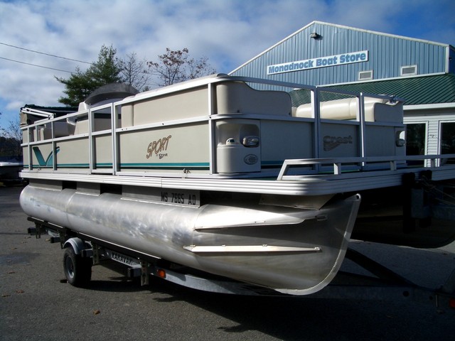

New to the forum. Just bought a used 2002 Crest 20Ft Sport. It has a 40 horse 2 stroke which has a built in oil mixing tank. My neighbor recommended to still mix the gas/oil for the first tank of the season. This would insure that the mixing injector is working(level will go down). He said there will be no engine damage if the gas is oil rich. Does this seem to be the correct thing to do? Any other tips would also be appreciated. Thanks.

2002 20 Ft Crest Sport
2002 40Hp Mercury 2-Stroke
