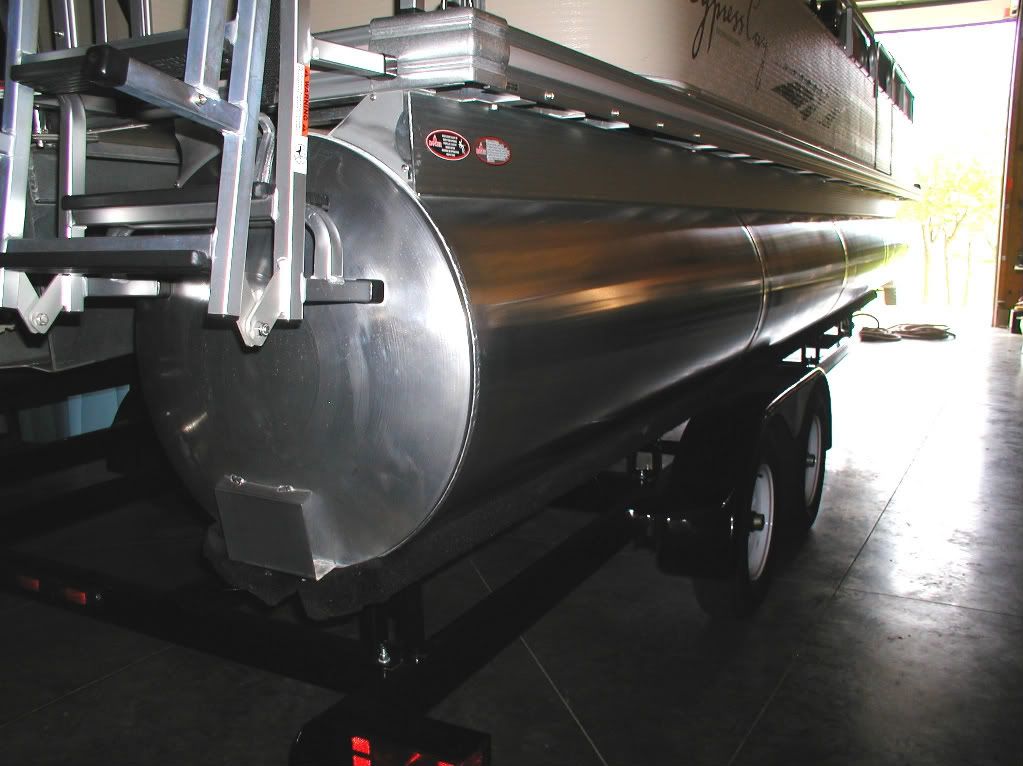

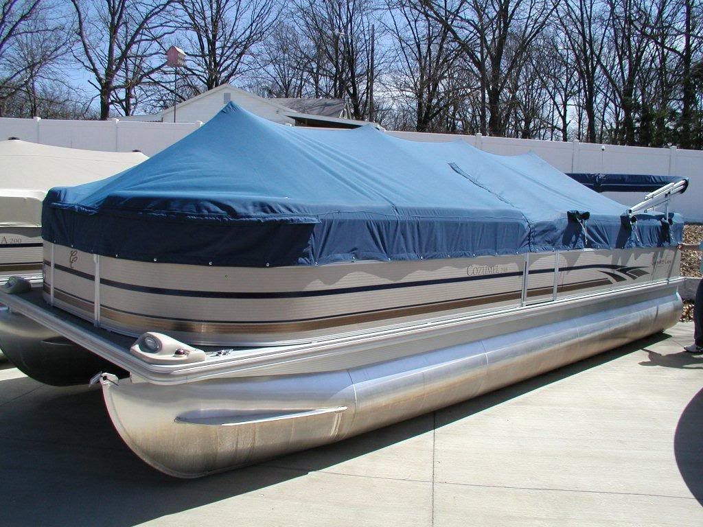

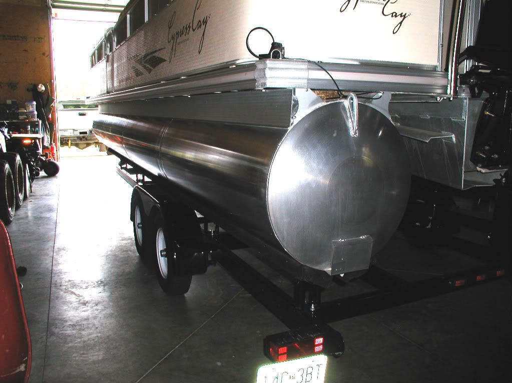

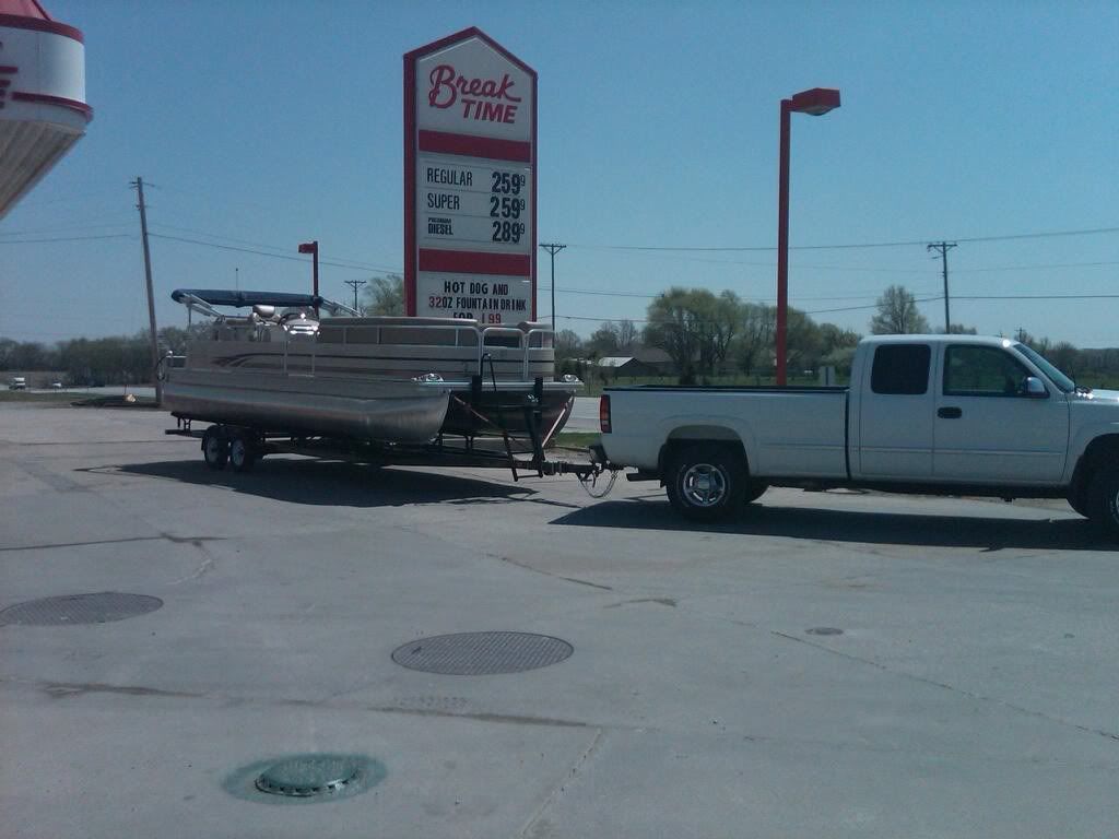

I bought a new 2009 Cypress Cay Cozumel 250 and had the dealer hang a 2008 Optimax 175 Pro XS on the back of it.
Here is what it looked like on the lot, and on the way home...

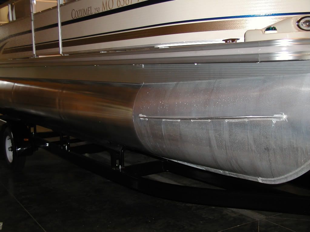

As you can tell, it's been sitting on the lot for over a year and actually spent a bit of time last year in the water as well as a demo. I think the dealer used some sort of acid cleaner to clean the toons back up a bit and while it got the heavy stuff off, it also etched the aluminum and left water marks on them as well.

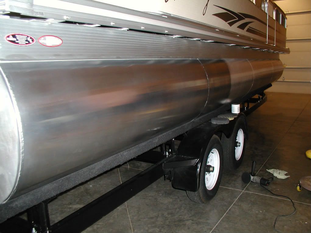

While I got a GREAT deal on the boat I just couldn't handle having my brand new boat looking like that. So I read up a bit on machine polishing and Sharkhide treating then got busy.

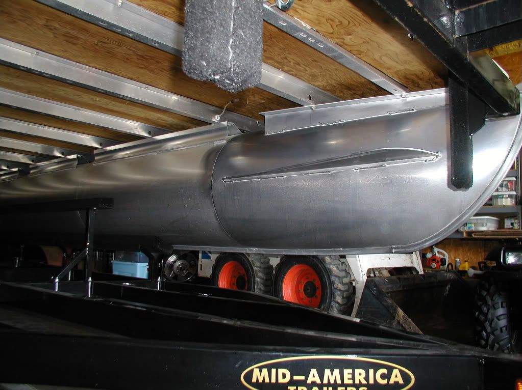

Here's a couple once finished with the polishing
I only polished the insides on the first section, I want the boat to look nice, but I ain't crazy either... :P
Last night I wiped the Toons completely down with lacquer thinner (twice) and tonight I'm applying my first coat of Sharkhide. I've purchased 6 cotton baby diapers and have watched the videos...so I think I'm ready to roll.
My question is, how long should I wait before putting a second coat on and then how long should it dry before putting it in the water?
Also, will one quart go far enough to do two coats on both the insides and outsides of the 25' toons?

The can doesn't say anything about a second coat...I seem to remember something was said in one of the videos I watched about applying a second coat, just to make sure you didn't miss any spots.
The can also doesn't say anything about coverage area.
If nobody else can help with what they experienced, I'll give Clint a call. Hate to bother him with a not quite so important type of question if I don't have to.

I think you will be really close at 25 foot, I had maybe 1/4" left on 22 foot toons and I only did the outside and what I could reach of the inside on the ends.
Cure time between coats depends on, temp and humidity. Could be any where from 3 hours to 24, I personally waited 24 hours inbetween coats.

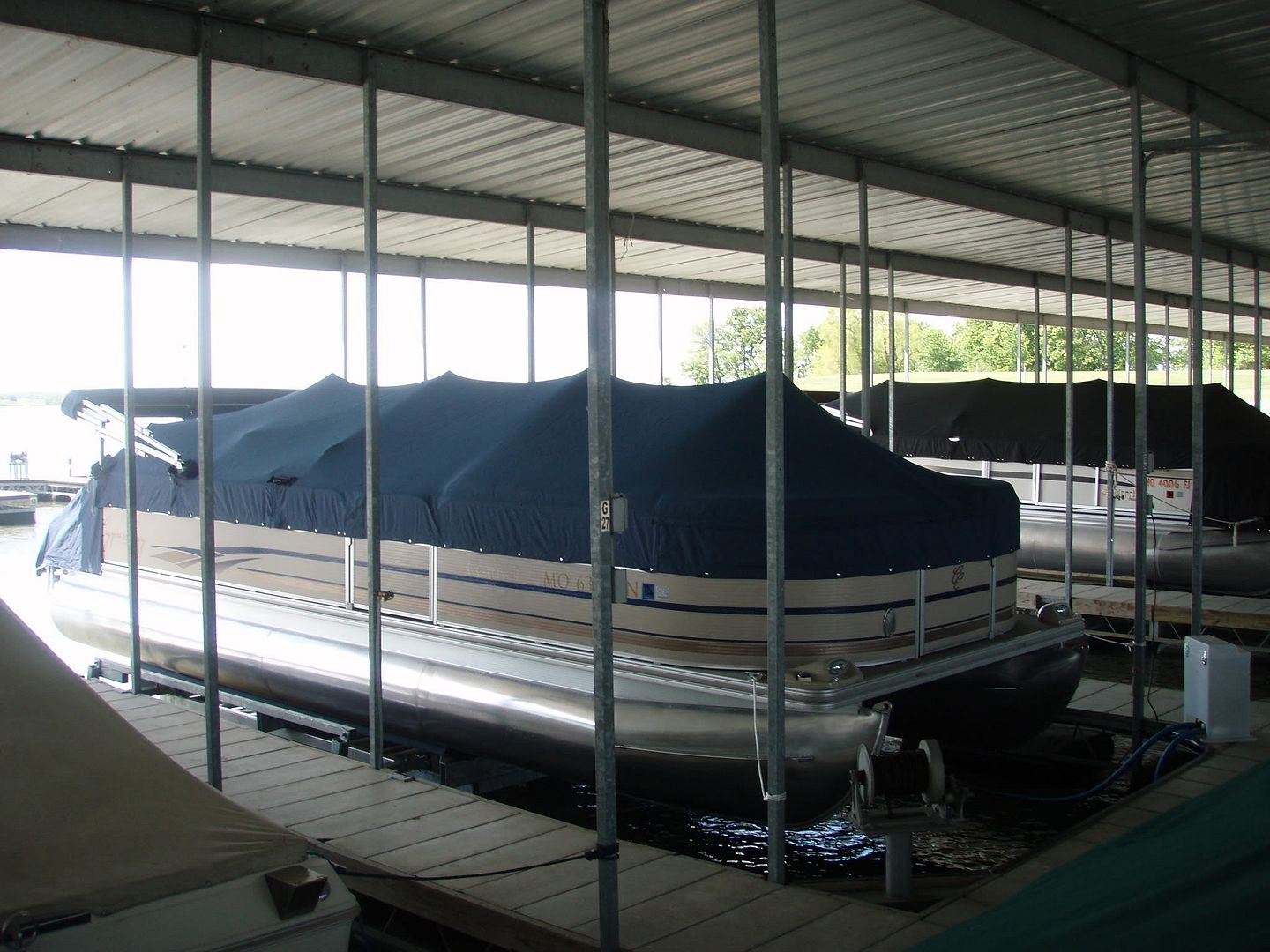

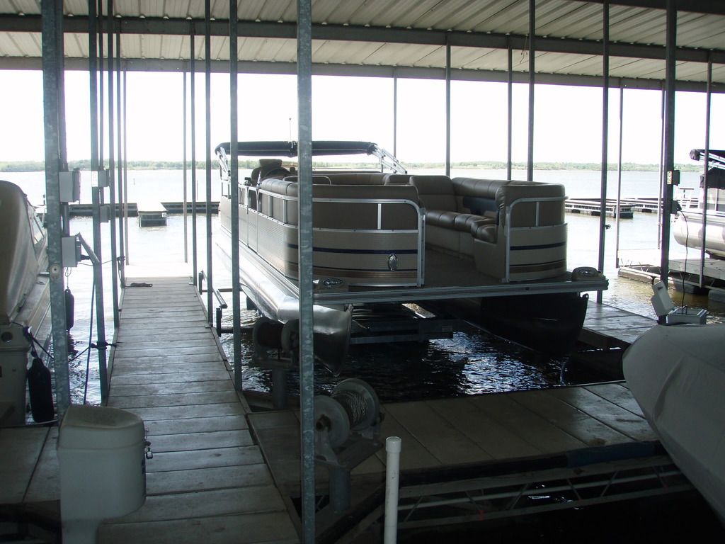

Well, it's now in the slip and ready for summer to get here...this explains why the weather turned to crap at the same time...
A few more pics...
