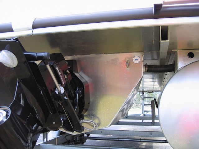

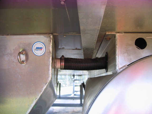

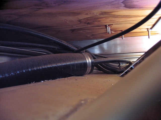

here are some pics i took of an 09 model at bass pro last year when i was trying to figure my problem out.
- IMG_3612.jpg (61.16 KiB) Viewed 4168 times
- IMG_3608.jpg (58.83 KiB) Viewed 4171 times
- IMG_3609.jpg (73.79 KiB) Viewed 4170 times

That is almost exactly like my hose in those pics....
