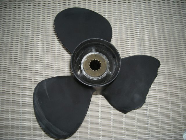

Well we had a bad day on Memorial day, broke a prop so now I have a new cup holder on my deck. Oh well, thats life.
- brokeprop.JPG (75.14 KiB) Viewed 6122 times

Prop shop could fix it and I won't even say how a prop guard would have saved the day

Holly crap!!!! You took a chunk out of that prop. I would check the prop shaft and make sure it's not bent. Eye ball the end of the shaft and spin it.
