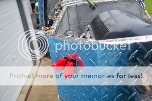

Sooo, between the pc issues and the Photobucket issues, I am finally getting around to the rest of the story here...late as always :smoke
I was gonna dole them out a little at a time, but couldn't, so now you get 'em all at once:

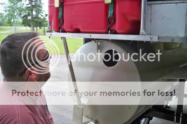

This is what prompted the project in the first place. A little scary early this spring. Water was in the thirties.
Drilled a few more holes. Obviously one wasn't enough.

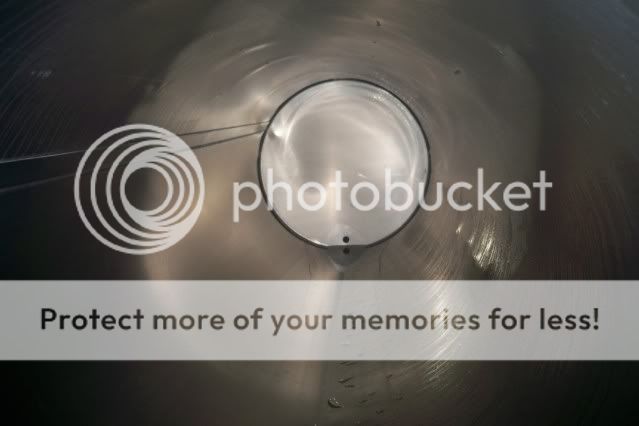

What the inside of my tube looks like.
It rained for about 2 weeks. Good time to be in dry dock. Lake was low and needed it.

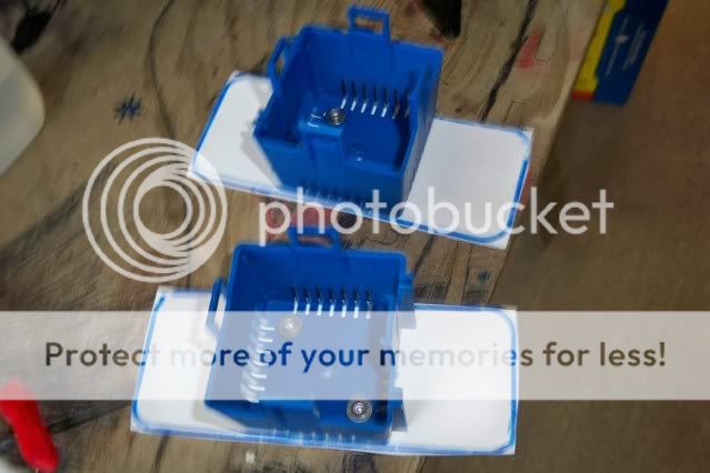

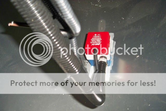

Pump bases riveted to plastic mount plates, then epoxied into the tube.
They're in there!

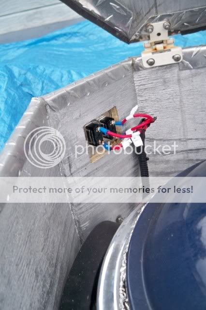

Switching (straight manual) in my home-built BBQ box.
Keep your wiring neat. Hopefully it'll survive the grease :prayer

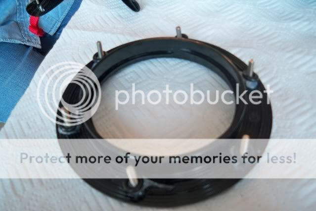

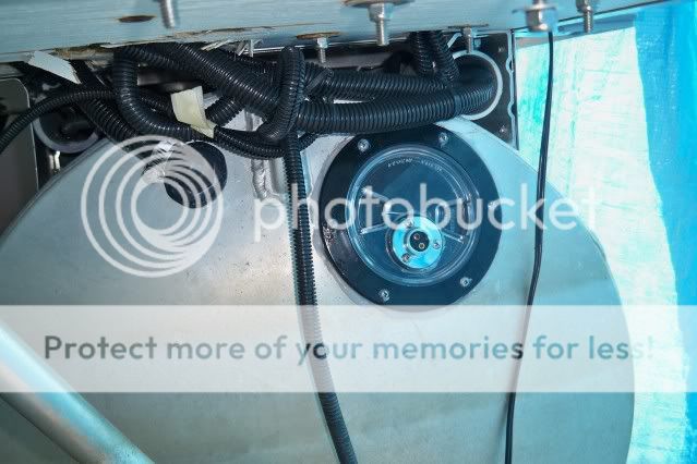

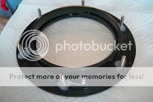

The meticulous job of mounting the deckplates.
O-ring spacers
Even more silicone. Making a thick rubber gasket.

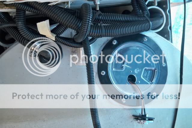

Ring is in there. Note the outlet hose to the left. There was not enough room in the lids for the fittings. Plus the hose wouldn't have twisted enough to screw in the lids. Thus, they got their very own personal holes.
Power thru hulls, aka bulkhead fittings.

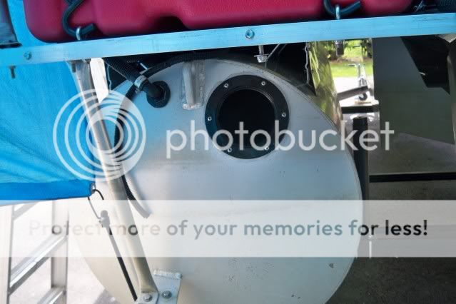

Getting close.
Done!
