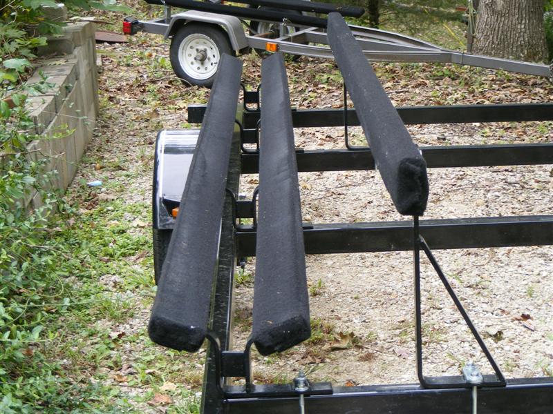

Though guides are very beneficial and useful, the vertical upright guide posts are in a since as useless as tits on a boar hog. Try to find a supplier of the style posted below and I guarantee you'll be a happier for the long run.
Re: Trailer Guides
Bamby is right find you a welder and have him make some L brackets out of at least 1/4 steel. To these attach a carpeted 2X6 or 2X4 at least 10ft long. have them made to clamp on using U bolts. Fit them no more than 2 inches from logs. Those you show are not very good and have no bracing to keep from bending in high wind or wave conditions.

I have a triple tube. My guides are just like the ones Bamby showed in the picture. The guides run along the inside of each outside tube. There is plenty of room to get the center tube in between those guides as the guides are just about 2" inches away from where the outside toons need to rest. There is no guide for the middle tube. My guides do not come all the way back to the back of the trailer (it looks like Bamby's do), but probably just about 1/2 way back. I did not like that at first, but then I realized that if they came farther back they would be too deep to do any good (at least on the ramp I have been using -- it's kind of steep).
I have only loaded it a few times so far, and once in a decent cross wind. This system seems to work well for the triple tubes. Once you get against the guides, the boat has no choice but to load right.
I'm new at this, but so far I would definitely recommend guides like this (see Bamby's picture) even for a triple tube. Hope that helps.
