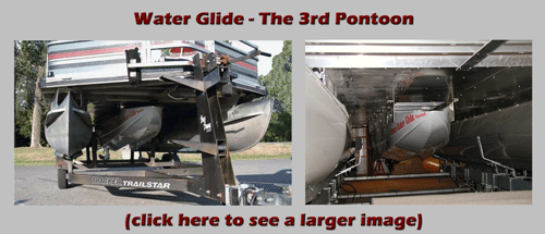

Have you seen this product? Man I read about this in PDB and I thought it was pretty cool, but a little pricy. It is kind of like adding a 3rd log to a boat like yours, but it is supposed to really help boats with smaller HP motors like yours.

- waterGlide2.gif (61.46 KiB) Viewed 19527 times

Cheaper to add a third toon and you get more flotationtexaspontoon wrote:Have you seen this product? Man I read about this in PDB and I thought it was pretty cool, but a little pricy. It is kind of like adding a 3rd log to a boat like yours, but it is supposed to really help boats with smaller HP motors like yours.

I called the good folks at Water Glide and ask about benefits for my toon. They told me it would not provide any benefit for my 50hp, if I remember right I was told for a 20 foot toon I would need at least a 60-75 hp to see benefit. I found them to be a very honest company.
