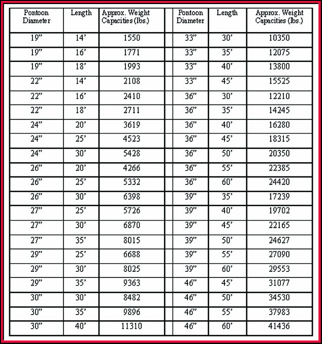

How much weight/people can I have on my boat? 78' Lowe 24' pontoon. 35 horse (hp restricted to 40).
Anyone with an idea of how much weight is ok for the boat? I'm a total newbie to boating. Thanks guys.

there is usually a sticker on the boat which states it. all boats vary...mine is a 24' sun tracker and it is 15 people 2150 lbs

i dont really judge it on how many people...i look at the weight...remember the weight rating is gear, coolers, and people

Seriously though, I would measure the tube diameter, then the lenght, and see if there are similar boats that have weight stickers. Or you could call the manufacturer to see what they rated it for. As a last resort, the local wildlife and parks office may be able to give you a good idea. I would say that you should be fine with 9-12 people on the boat, if the weather is nice, and it's not too windy. With a 40hp. motor, you aren't going to go anywhere very fast at all with that kind of load, but you can still troll around the lake. If it's windy, then you may not be able to even go against the wind.

The recommended safe weight capacity is when the pontoons are one half submerged. Measure both the "Diameter and Length" of your pontoons and compare with the chart posted below, and you should have a pretty good idea of your boats capacity.
