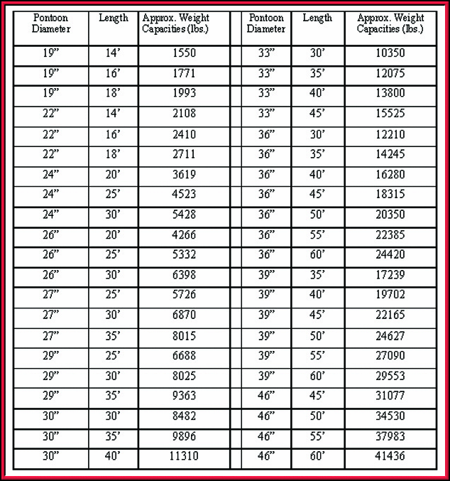

Start putting people on the boat, one at a time after all of your gear is on the boat. Make sure you are on the water. Once the boat starts to sink, simply tell two people to stay back, and there you have it, you know how many people your boat can hold. :rofl :rofl :rofl
Seriously though, I would measure the tube diameter, then the lenght, and see if there are similar boats that have weight stickers. Or you could call the manufacturer to see what they rated it for. As a last resort, the local wildlife and parks office may be able to give you a good idea. I would say that you should be fine with 9-12 people on the boat, if the weather is nice, and it's not too windy. With a 40hp. motor, you aren't going to go anywhere very fast at all with that kind of load, but you can still troll around the lake. If it's windy, then you may not be able to even go against the wind.

by Bamby
The recommended safe weight capacity is when the pontoons are one half submerged. Measure both the "Diameter and Length" of your pontoons and compare with the chart posted below, and you should have a pretty good idea of your boats capacity.
