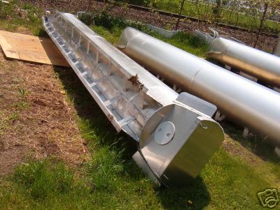

Re: Another Center Pod Qquestion
Have thought about going with a center log with a built in transome. There are several for sale on Ebay. Just remove your engine pod and install the center log. I'm sure one of those would hold your 115.

That's sort of along the line of the things I was looking at...the only concerns I had where length, shape, and diameter considerations.
To make this somewhat economical, I need to find a supplier with in driving distance of St. Louis, MO in order to save on the typical +$750 shipping costs. The longest longest U-shaped tubes I have been able are either 9' shorter and is 2" deeper, or 5' shorter and 1" shallower than my current ones (http://stlouis.ebayclassifieds.com/part ... ?ad=190027).
If I go for a 3rd tube then it would have to have a transom, otherwise I would still have to have the transom reinforced/ replaced.
