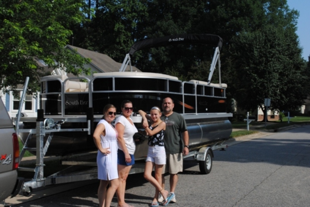

Good day to all. After looking for some time and procrastinating even longer, we finally bought our first pontoon. Actually ran into a deal on this unit; someone had ordered it and could not complete the deal due to loss of their job a day or two before picking it up and the dealer was looking to deal. We have only 15 hrs. on it so far.
I will be adding underskinning to it this weekend (our dealer would not do it). Found 5' x 10', 16Ga Al. sheets (0.063 thk.) for about $100 each. Will use thin weather strip on each cross channel and either 10-32 or 1/4-20 self tap screws to hold it on (predrilled holes in sheet and channels).
The distance between logs where the sheet would lay flat is 57.75".....my sheets are 60" wide.....question: it has been suggested (after a few brews) to leave the sheets a full 60" and start pinning from the middle or center of the sheet and move towards each log....leaving the sheet naturally bow or bend the last 6" or so and lay against the angles or cross members supports (hope this makes sense)....any comments welcome on this idea.
I have seen some of the pics posted and like the ideas I've seen and will borrow from them. If you have any hints, suggestions or warnings, let me know. I will also post some before and after pics.
- the new toon.JPG (312.75 KiB) Viewed 4306 times

Nice looking rig, Looseties. Welcome to the forum.

Welcome................Congrats on the new toon. just the right color for a pirate flag.
