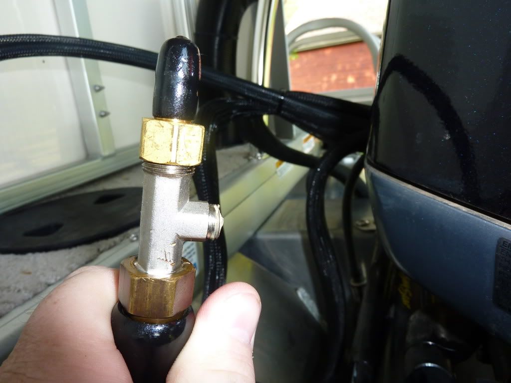

I bet someone cross threaded that T fitting, and when it leaked they just gave it another crank, and it was one too many.

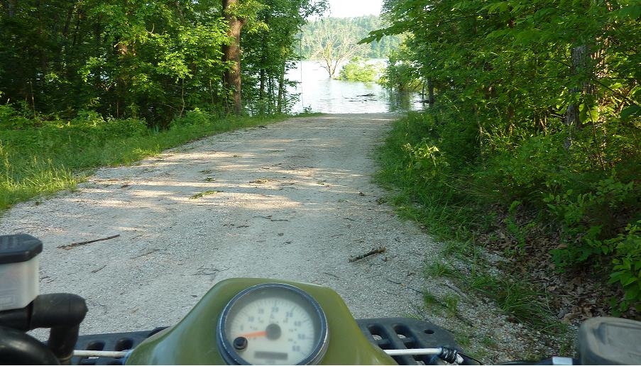

EDIT: Here is a pick from the 4 wheeler of where we normally launch, its usually over 5 times that distance to the water. Normally from where I am at on the 4 wheeler you can't see the water lol.

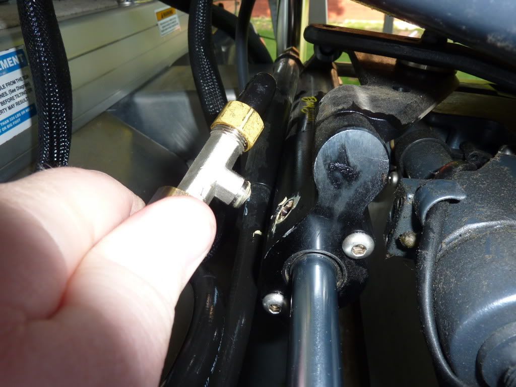

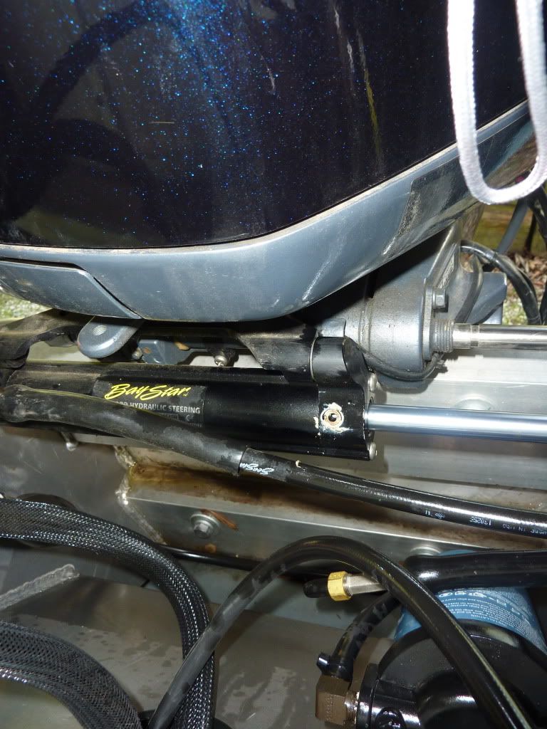

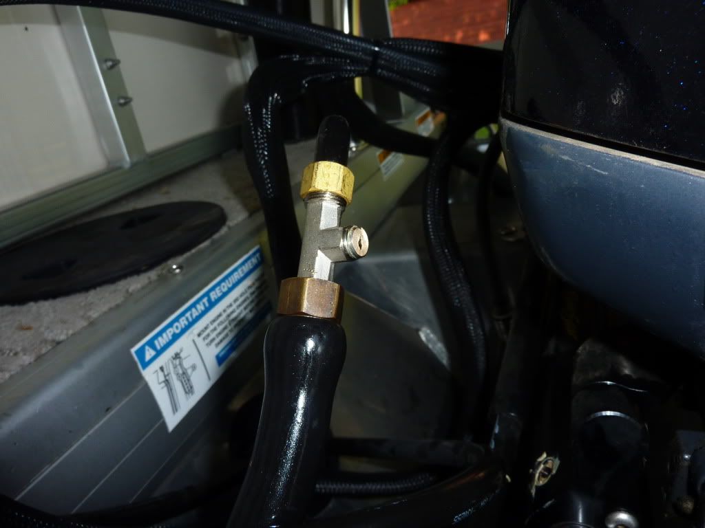

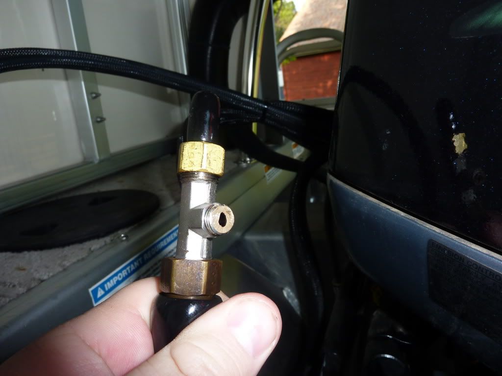

Here is where the line sheared off

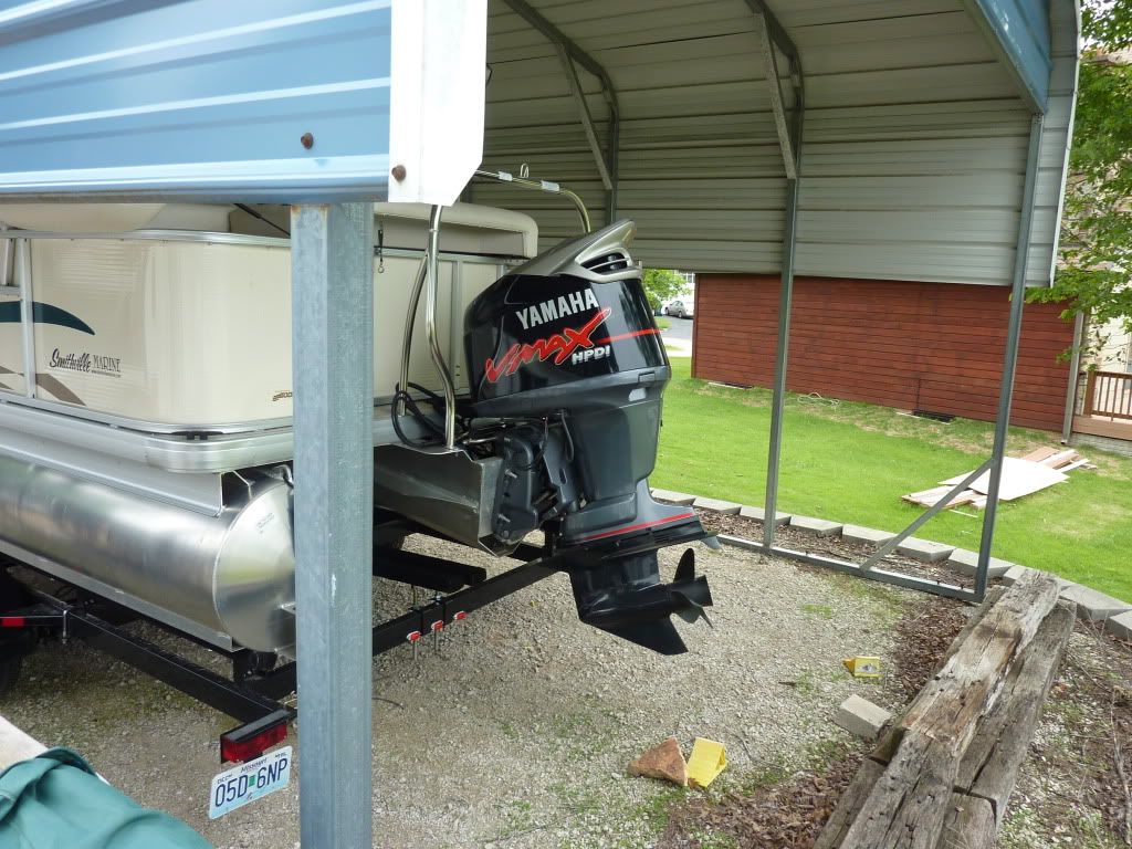

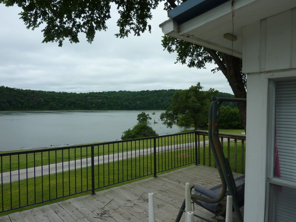

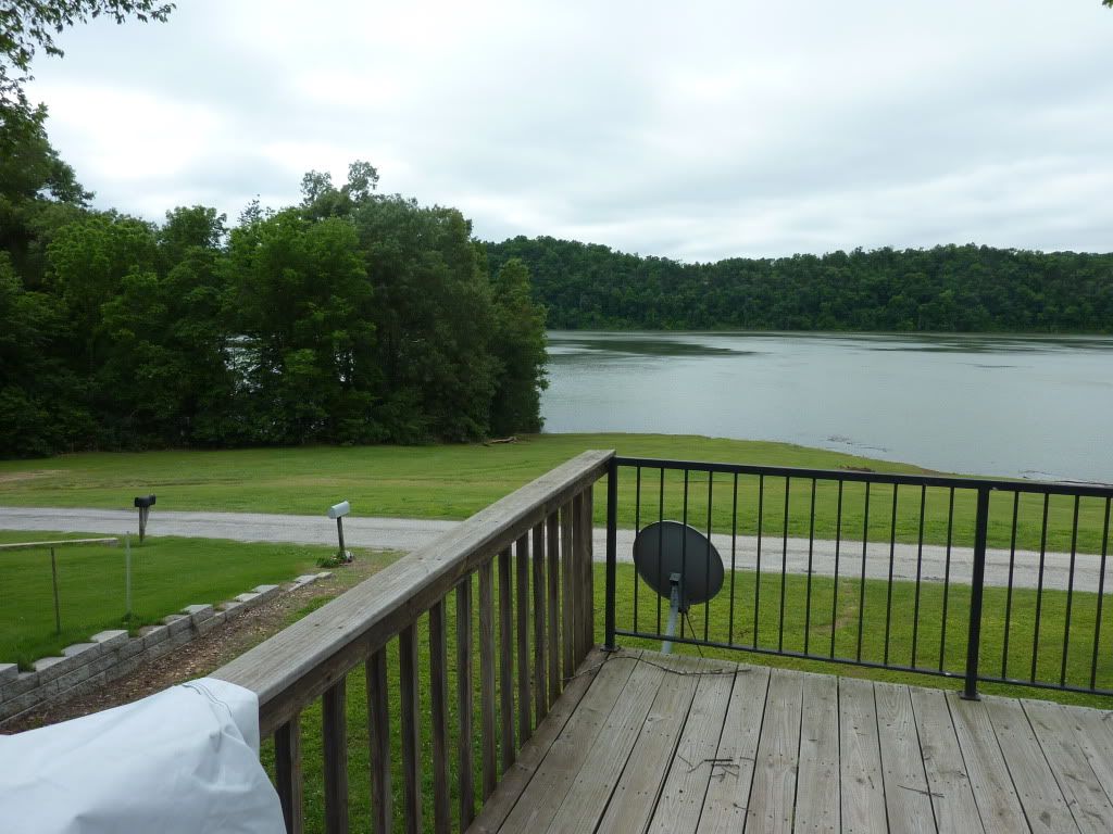

Here are a few of the boat:
And the lake:
View out the front door
From the deck left to right:
And the lake:

It sheared that off...so I don't even know if its fixable without replacing that hydraulic piston.

The dealer should make it right, but I tend to take matters into my own hands on simple stuff like this I would have to fix it myself and get back out on the lake. But I understand not everyone has the equal mechanical skills so without knowing you personally I don't know if you would be comfortable with doing it or had the tools.
The T Fitting is simple to remove, you could take a EZout and remove the broken off piece and you should be ready to install a new one.
Since the boat isn't that old it should come out very easy. Then take the fitting, both pieces to another marine dealer, get the t fitting and some teflon tape and put it in yourself. While your there, ask the dealer how to and if you need to bleed the air from the line because you will have some bubbles.
Or find a good close marine dealer and have them fix it if you don't have the tools or if you don't feel comfortable with the repair, only you will know if it is over your comfort level.

I'd probably fix that myself as well, it's not a complicated repair at all. Even if one has to chase the threads to clean them back up once the broken part of the Tee is removed. They are all just normal pipe thread connections.
At most a couple of trips to any hardware store (one for the easy out and thread chaser, then another for the new parts needed) and a minimal amount of dollars and she'll be good as new.

Just be very sure you flush out all the chips. I am not sure where that "T" is bit I would try to isolate that by getting all of the hoses disconnected so nothing goes any farther.
You can take the time or you might be tearing down the whole system later. If this is a warranty part you may want a good dealer to fix it.

bruuuuce- I am mechanically inclined although I have only worked on cars and I/O mercruisers, never on an outboard before. So the steering is something I have no experience with, to me it didn't look like the T fitting was threaded into the steering. Thanks on the lake front property, but its not usually that close, the lake is a full capacity so normally its like this:
playcat- They installed the motor/steering after we bought the boat, so assuming they had to add the fitting with the correct hoses.
LSVLance- I just don't see what its threaded into...unless its the cylinders cheap metal casing? Thats really terrible if it is.
Here are some more pictures of it, maybe I am just over thinking the situation, I am known to do that.

I was just looking at my own pictures and now I see what I didn't down there. I see exactly what I needed to do. Sadly it seems simple to me now. Didn't then, but I was fighting the flu down there, and the ten minutes of cold water only made it worse. We ended up driving in on Thursday(after stopping with grandma at all the headstones to put flowers on them) 7 hours. Then messed with the boat on Friday, it started pouring around 2pm. Then grandma and I packed up and left Saturday morning at 9am, then I had to get to work at Midnight.
If it doesn't get fixed at least I know what is needed now....I have the correct tools...at home. Thats the only downside to living 4 hours away from the lake. But its so cheap to live down there, actually the cabin a few down from me is going on sale in a month or so, it sits just as close to the water...and they are asking $75,000.

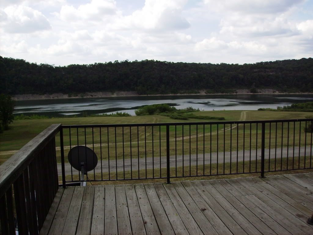

The one in the middle, the shed in the background is where my jet ski's, and the pontoon will be stored during winter.
Our cabin is the middle one in this picture, the A frame next door is for sale, although someone told them if it was lake of the ozarks it would be worth $300,000...so they listed it for $275,000 lol....yeah right.....

I guess what everyone is sayin, is the remaining threaded part is broke off in the cylinder - see your last photo. Ya can see the rest of the threaded part.
Here is a link to the BayStar/SeaStar selection and installation guides - http://ww2.seastarsteering.com/PDFs/PDF_files.htm
