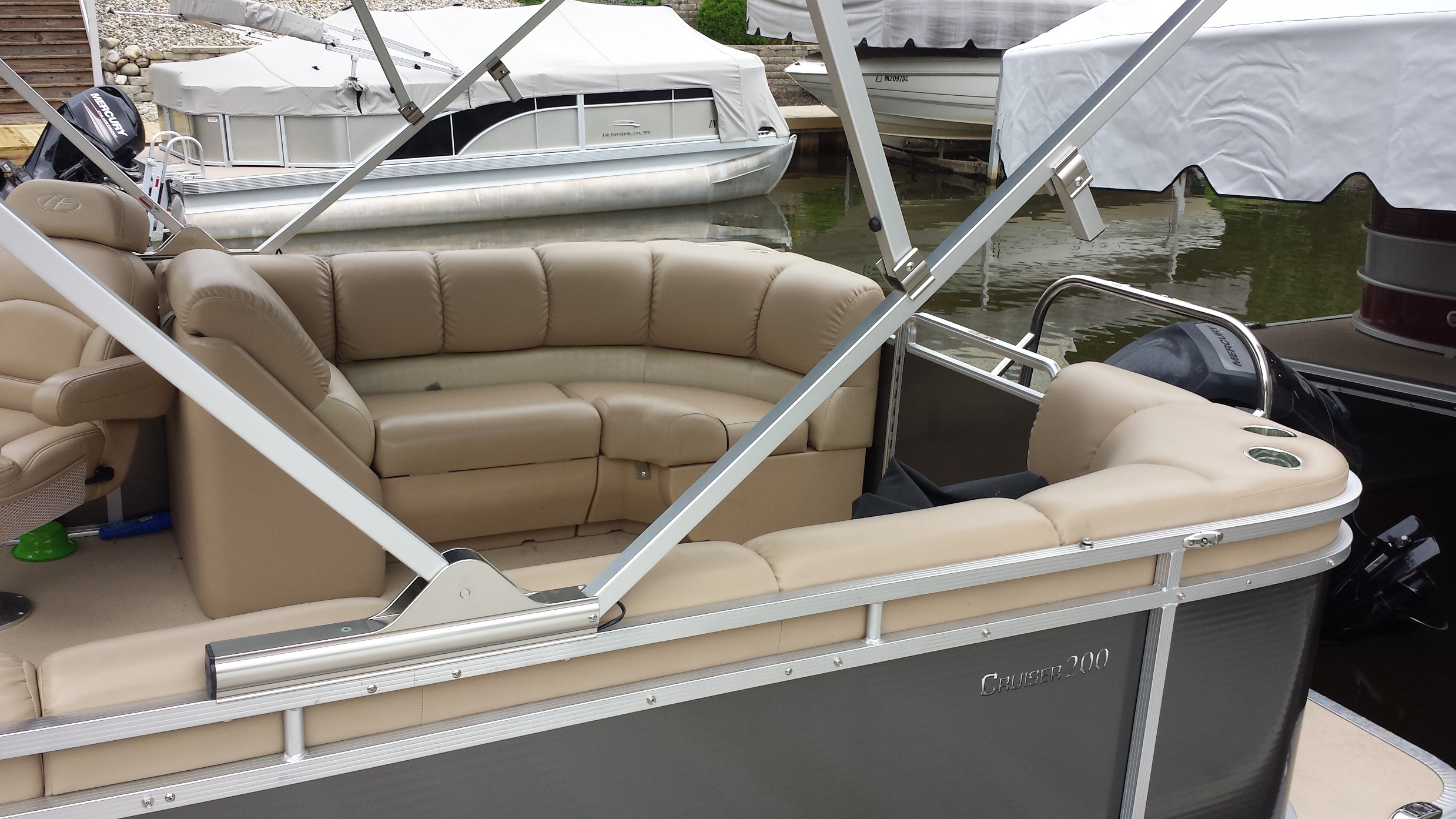

here is photos of my install, i have my cover at Angola Canvas to modify it to clear the larger actuators
Mike
