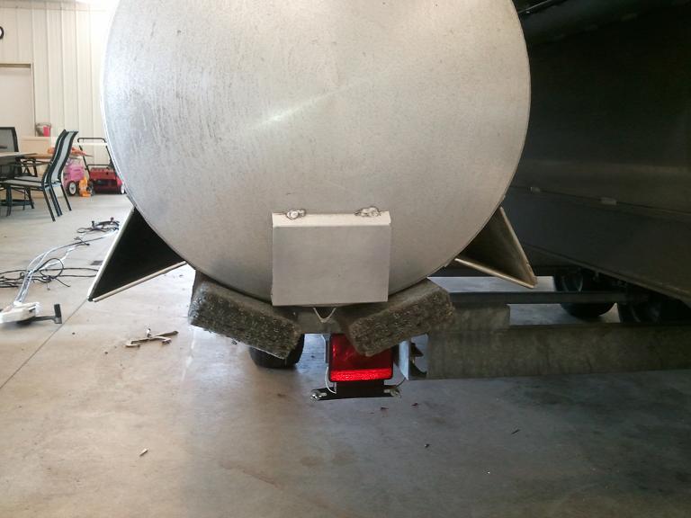

Hyd steering is NOT power assist. They have standard hyd and power assist hyd. The power has a small electric pump mounted some where near the motor. Here are 2 pics of lifitng strakes from various manufactures...
- 2012-09-18 14.11.44.jpg (59.72 KiB) Viewed 11211 times
- 2011-05-29 11.09.57.jpg (55.18 KiB) Viewed 11203 times
