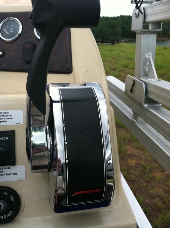

I took the cover off of my Mercury control this weekend to see if I could adjust the friction. There is nothing obvious to adjust...just some mounting bolts and two very small holes above and below the handle. I couldn't see in the small holes as the steering wheel was in the way.
My throttle looks just like the one in the link below. Any more specifics on what example I am looking to adjust?

Think I just figured it out. According to this previous post, hopefully I can reach the nut from the underside of the steering console. Otherwise I will have to remove the mounting bolts from the throttle assembly and pull it up a bit to see the nut.

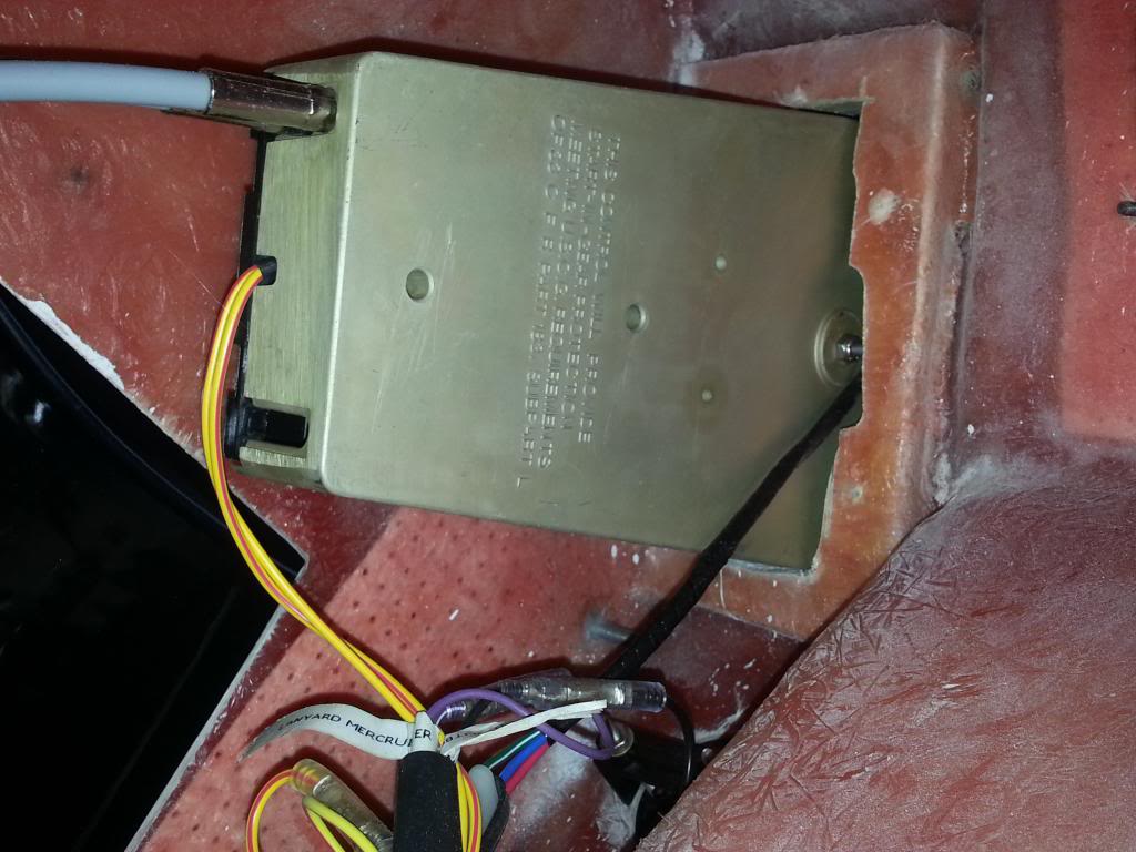

I was able to crawl underneath the steering console this weekend to locate the friction control nut. Looks just like the picture below. I'm a small guy so I was able to reach the nut from underneath and give it about a 1/4 to 1/2 turn with an open ended wrench. Adjustment worked perfect!
Thanks for everyone's help.

wait, my boat does this too, which nut did you turn on your picture?
Re: preference between mercury and yamaha motors
The nut on the far right side of the picture....just under the fiberglass console with the black wire over it. Depending upon your shifter model, the nut can be reached by either on the top,of the console or below.

And I just want to tighten it correct?
Correct...tighten it and test.
