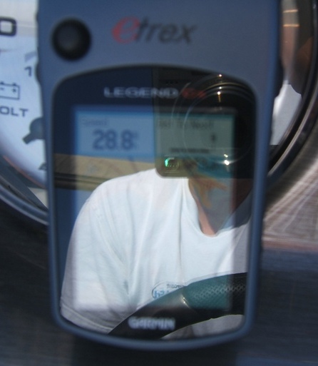

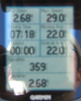

Figured I would share my experience with TP Prop
Okay so I tried the Hustler prop and here are the results.
2008 JC Neptoon 25' Triple tube w/ 2008 Honda BF115
Stock Solas Prop 13p
5800rpm and a top speed of about 28mph
Hustler Prop 13p
5900rpm and a top speed of 29mph
In addition to the 1MPH increase I noticed a significant increase in Hole Shot and less cavitation in turns. With the stock prop I had a significant decrease in speed when making tight turns which made tubing boring to say the least. This time I dropped to about 26 mph in a hard turn.
The Hustler prop was well worth the money.
