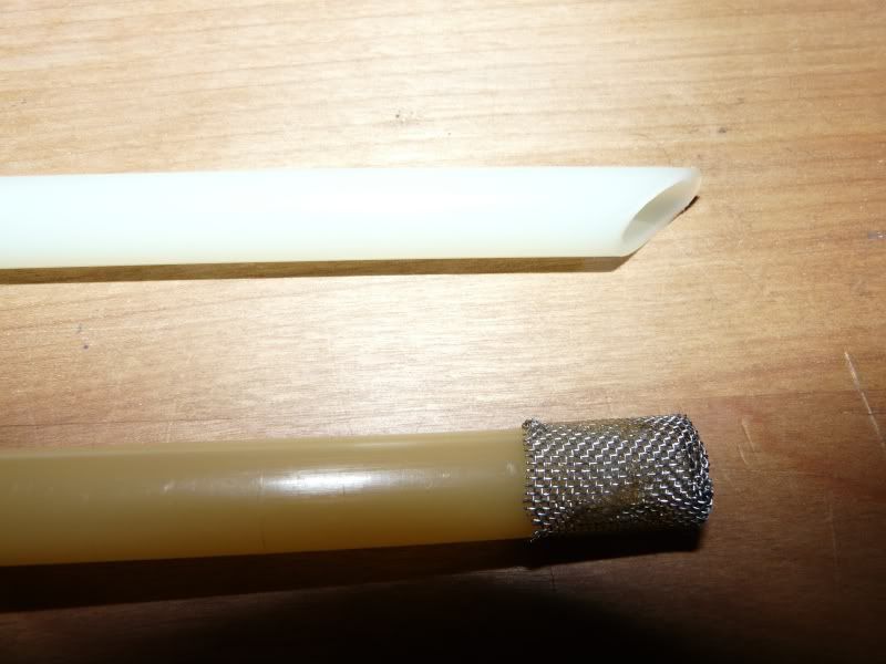

Parts came in early today, so hopefully I'll have the PC up and running tomorrow. Also found another potential issue:
Bottom is the factory fuel tank withdraw tube, top is the replacement from Moeller. The problem with the withdraw tube being cut flat is with a poly tank, they flex enough to have the withdraw tube hit the bottom of the tank, thus blocking off fuel flow. Clearing is only 1/4 inch, tank flex can be an inch or more. Also, the new part says the screen is unneccessary, to discard it.
In the automotive industry, we called that a "silent recall" on both counts. :tofunny
The withdraw tube should always be cut at an angle on poly fuel tanks, if not just for flexing and expansion/contraction in case the tank is where someone can sit on it and block the tube...
Now I hope nothing made it's way to the carb. Unlikely due to the fact there's 2 filters after the failed fuel line.

I would remove the screen because if something "should" get in the tank it will get cought by the screen and stop up the fuel system... THAT said i run a "inline fuel filter 6" from the tank on every boat i own, this keeps junk from getting anywhere near the fuel pump or carbs/inj system AND i cary a new filter in a zip lock bag in the tool kit/glove box they are cheap and having a spair filter is better than a Tow anyday :) BTDT dont want to do it again.... and yes cut at least a 45* angle on the pick up tube :)

Disassembled the carb today and found yellow jelly-like crap inside. This is despite stabilzing, topping off the tank, etc.
Check out the corrosion at the bottom of the fuel bowl..2 1/2 year old carb. Yellow substance is suspiciously the same color as the fuel line plastic liner....

looks like you need a water seperator OR a better one :(

I have a Mercruiser spin-on type. Wasn't installed until after the first season we had the boat though. I also sent my pics to the owner of our marina. His reply:
"Ed we have seen this before, in what we feel is the biggest EPA stupidity in our view. They require a “blend in fuel change” each year. This is causing a varnish to build in the tank over the winter when the winter and Summer mix of fuels is combined and left for awhile. They do sell a product for this. You can stop in the office and we can show you it. With this said, we have had to replace close to 100 boat's Fuel lines, pump their tanks and carb work, because of the this issue. Let us know if you need more information".
