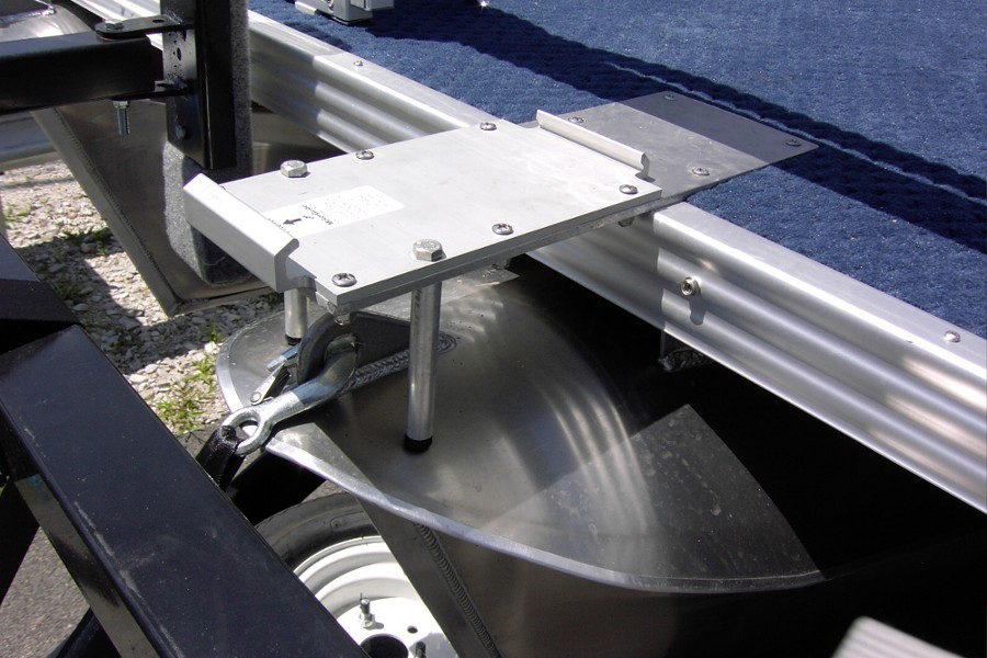

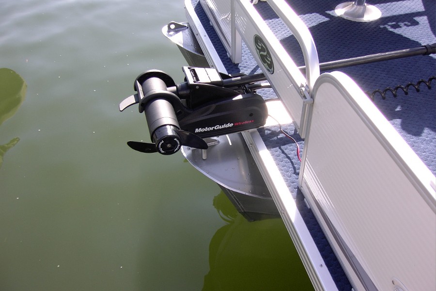

I've got a 24V motorguide 74 pound thrust with wireless remote controls (don't remember the model number). It moves me about 4 mph. I'm very pleased iwth it.
Mounting was a bit different as there's no good place to put this puppy. We ended up building an extended platform over the nose of the center tube and mounting the base there so that the motor drops just in front of the tube. The first picture (hope these aren't too big) shows the mounting plate. The second shows the motor installed.

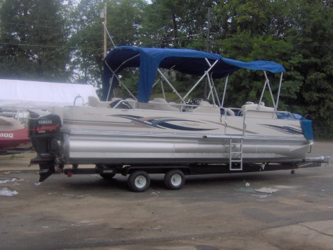

And since we're playing with pictures, here's my boat
Port side before adding the 5 step ladder. Note that I have different seats up front. I added the two reclining shairs up there (One was supposed to be mine but I've never fished from it yet. My guests always grab those first)

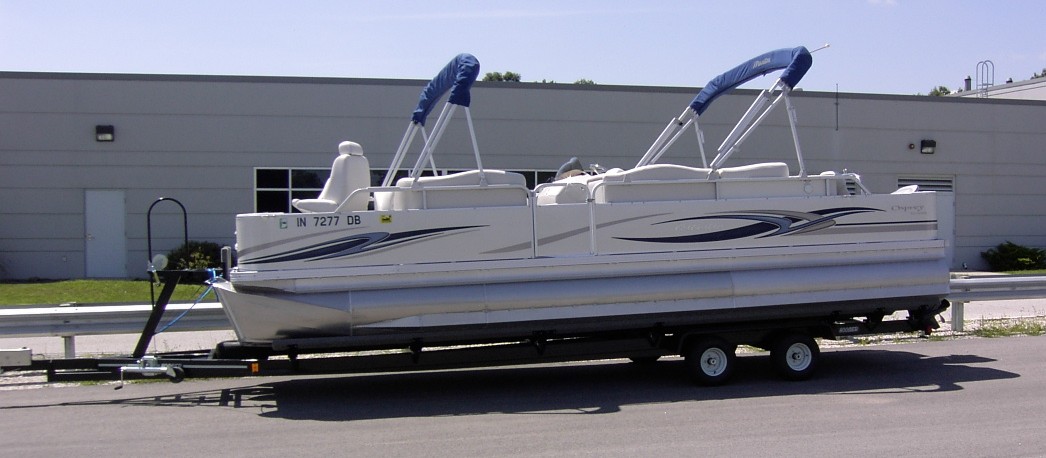

Stbd view. The blue up front is the plastic they had it covered with. I wanted a pic of the biminis and the ladder. Note how the ladder stays attached and just flips up and slides aft when not in use. The ladder on the port side has one more step. They do not interfere with the biminis or the covers.

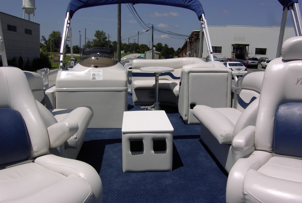

And one last one kind of showing the seating arrangement.
