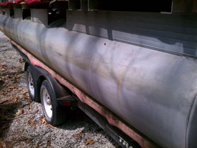

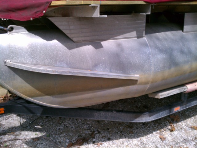

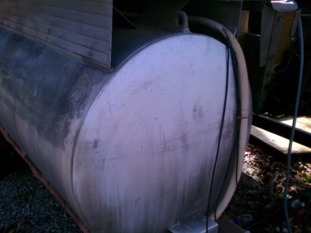

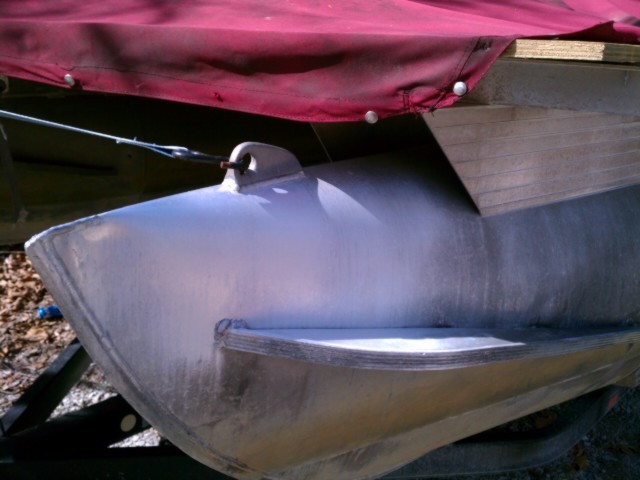

Re: TOON CLEANERS
curtiscapk wrote:That looks AWESOME! I am going to try the toonbrite cleaner tomorrow will make sure and take pics to compare....
Toon bright didn't far too well. I am not sure if my toons were just too dirty or it just doesn't work as well. The very front and rear turned out great!!! I may try on more bottle. I used half on this side will do other side next weekend.

Re: TOON CLEANERS
Craig, it looks like it is trying to work. It may just take more applications to get it completely cleaned. After the first application of the Napa stuff, I had some of the same "clean" streaks that you are seeing. When I went back for a second application, all of the "clean" streaks went away and the toon looked much cleaner.
I wonder if the toonbright stuff you have just isn't as strong. But it does look like it is doing the job.
