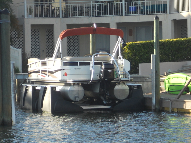

GregF wrote:It makes me like my lift more every day. Best $1000 I ever spent when I think of what 20 years of bottom paint would cost if the labor was free
You should go into business. In my neck of the woods a professionally installed 10,000 lb lift goes for 11-12K.
I'm still trying to find out who makes this.
floating lift 2.jpg (215.56 KiB) Viewed 2134 times

My lift is a lot simpler than that. It is just 4 pilings, an Ace 401 lift plate and some pulleys and bearing plates on a 2x12 frame. It has lived here 20 years through 2 major hurricanes and a half dozen minor ones.
I pick up the boat with the lift rings.
You certainly do not need a 10,000 pound lift for a pontoon boat.
I did do all the work myself but it was pretty easy. Setting the pilings is the hardest part. In deep water like you have I would farm that out to a contractor. The guy who just did our community docks used a long stick boom truck and was able to reach out almost 40' to get the outboard pilings driven in. They might bring a barge for yours.
I did get the Ace parts wholesale and that helped but I think the whole thing is still only about $1000. The wood and the pilings is the wild card.
Marine contractors do charge a lot of money for what they do.
The dock the HOA had built was $6,000 and a similar one we built ourselves was less than $2,000
