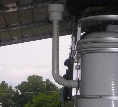

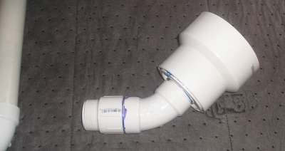

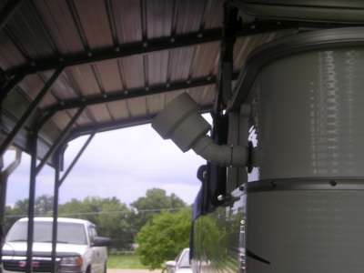

#3 Post by Bryden24shp » Mon Feb 13, 2012 3:05 pm
Mine was vented through the cap, originally, what a pain to fill the tank. The gas pump always cut off, gas burped all over the place. I got more gas on me than in my tank, sometimes. I bought a vent kit through Overtons and installed it. It works great. I also built a filler funnel that screws into the cap. The tank fills real easy now, no burping or sloshing. With 2 different lengths of PVC, I can fill it up easy on the dock, or from inside the boat. Was easy to install. Works fantastic. Just like my EzFenders, get an idea, tweak it untill it works....And it does....
Bryan
