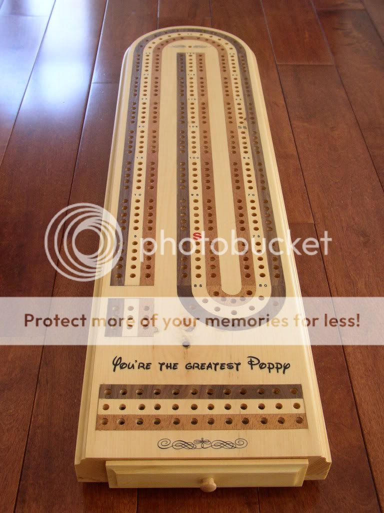

If I lived much closer I'd drill them for you. As a hobby I made personalized handcrafted cribbage boards and have drilled more holes than there are oil wells in all of Texas, LOL.Drago wrote:I'm really not looking forward to drilling all those holes! The adhesive to do the same job would run near $270 whereas the screws run $30-$50. I would rather wear out my back and some drills and keep the change.....
Here's a sample with a mere 406 holes each drilled individually:

That's some major cribbage board! I haven't thought yet about making a jig to set up the work flow. When I get the plastic in hand and get the boards cut to size, I'll have a much more clear line on the undertaking.
