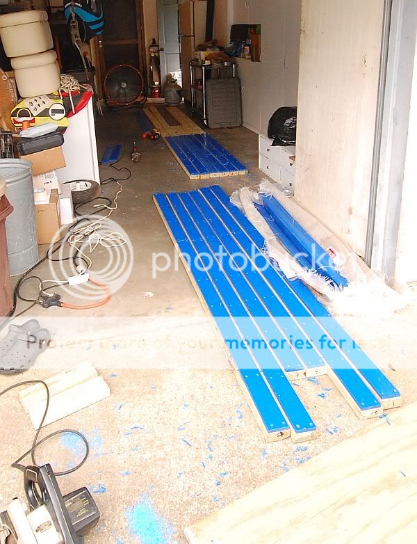

I did remember to take a couple while working on the project which was more work than I thought it might be.
The total bill came to $375 clams. Stainless hardware alone was $85 and I did not even use 316 stainless (used 305), lumber $37, 120'x3"x1/2" of UHMW $225 including shipping, and waterproof construction adhesive $17 (Loctite PL Premium polyurethane) which I decided was good enough since I placed a pair of screws every 10" countersunk 3/16". The real deal to glue UHMW to treated wood would have been about $170!!
I personally feel good about the project since the original wood was falling apart after only 4 years of intermittent dipping. This stuff is not wrapped in carpet and appears to be completely dry after the very short drive home from the marina where we launch.
