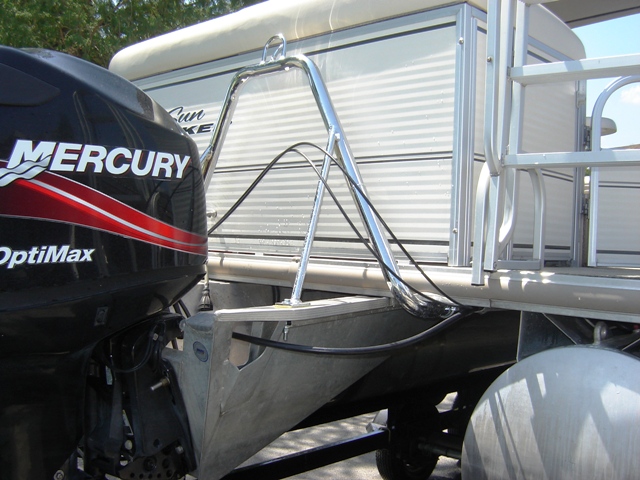

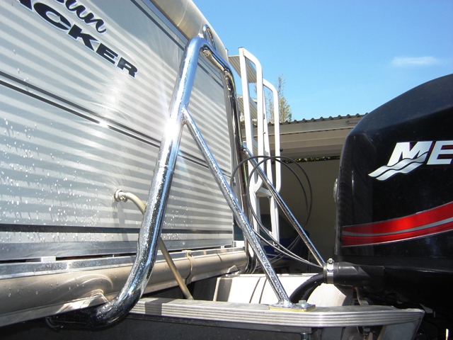

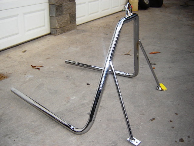

I own a 2005 Regency Sun Tracker Party Barge. As the engine is fast enough for skiing and tubing I decided to build a tow bar custom made to fit this pontoon. After I finished the bar, installed it and tested it, I can tell you that it worked great. It is strong enough to pull anything in the water, it does not damage the toon as it is very well fixed with several suports and it does not get on the way of anything on the toon, besides it looks nice!!
I made it myself using a mufler pipe bending machine and had it chromed at a local shop.
Hope it helps some body wondering if they can put a tow bar int their pontoon.
Attached are some pictures of the bar.

- This is a view from behind the toon to see how the tow bar clears the top of the ouboard.
- DSC02911.JPG (147.63 KiB) Viewed 12824 times

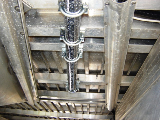

- This is a view below the toon to see how the tow bar is attached to the cross members.
- DSC02908.JPG (188.37 KiB) Viewed 12809 times

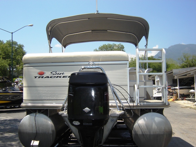

- This is a view from other side of the tow bar already mounted.
- DSC02906.JPG (156.89 KiB) Viewed 12808 times

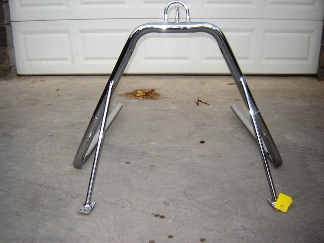

- This is a front view of the tow bar before mounting.
- DSC02847.JPG (157.93 KiB) Viewed 12798 times

Looks great man, that was a great idea to bend the pipe back under the boat to catch several cross members!

Looks Nice. How are you attaching the rope to the bar?

Wow! That's the most over engineered tow bar I have ever seen. That is the way the other manufactures should build Theirs. Excellent job it should last you the rest of your life.
One question I do have is. How much clearance did you give the rope over the top of the motor. Will the rope rub on the top motor cover?

Fredeboy: As you may notice, there is ahook at the top of the tow bar where I attach the ski rope with a couple of loops and off we go!!
Besides, the hook is very easy to reach from the back seat of the pontoon.

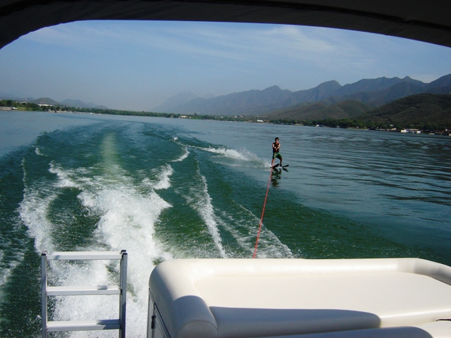

Jimrs: I made a "prototype" model of the tow bar with PVC pipes and attached it to the toon to do some clearence testing before building the metal tow bar. Afterwards I have done lots of testing with tubes, water ski and several towables and have no clearence problems neither with the motor cover nor anything else so far.
You may notice on the picture I post here with my boy waterskiing, the rope is far away from everything.

- TESTING THE ROPE CLEARANCE
- TESTING THE ROPE CLEARENCE.JPG (135.42 KiB) Viewed 12627 times

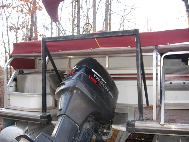

- Posts: 5446
Re: TOW BAR FOR A PARTY BARGE
Bad Ass!! looks a liittle better than mine.
- IMG_1365a.JPG (156.31 KiB) Viewed 12474 times
