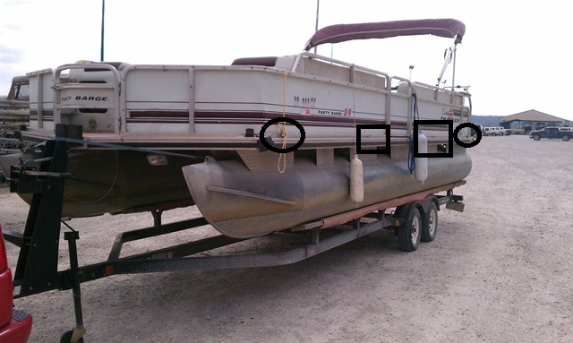

Mine is a 94. Previous owner put in circle bolts on corners and two cleats on the sides.
First pic shows you not much rail, and you can barely see the eye bolts. Huge steel plate under deck with washers.
2nd Pic is a little distant but you get the ideal. My bow anchor is attached to Starboard side. Stern anchor attached to port side. This bow line port side in the pic is a "life line" for floating.
