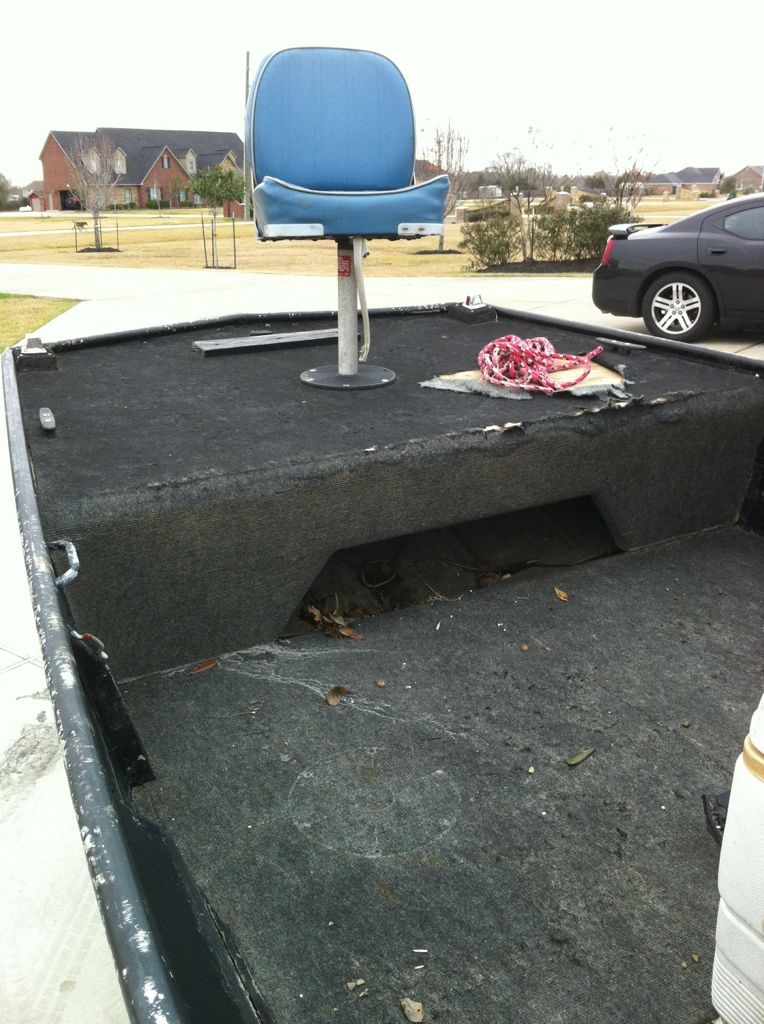

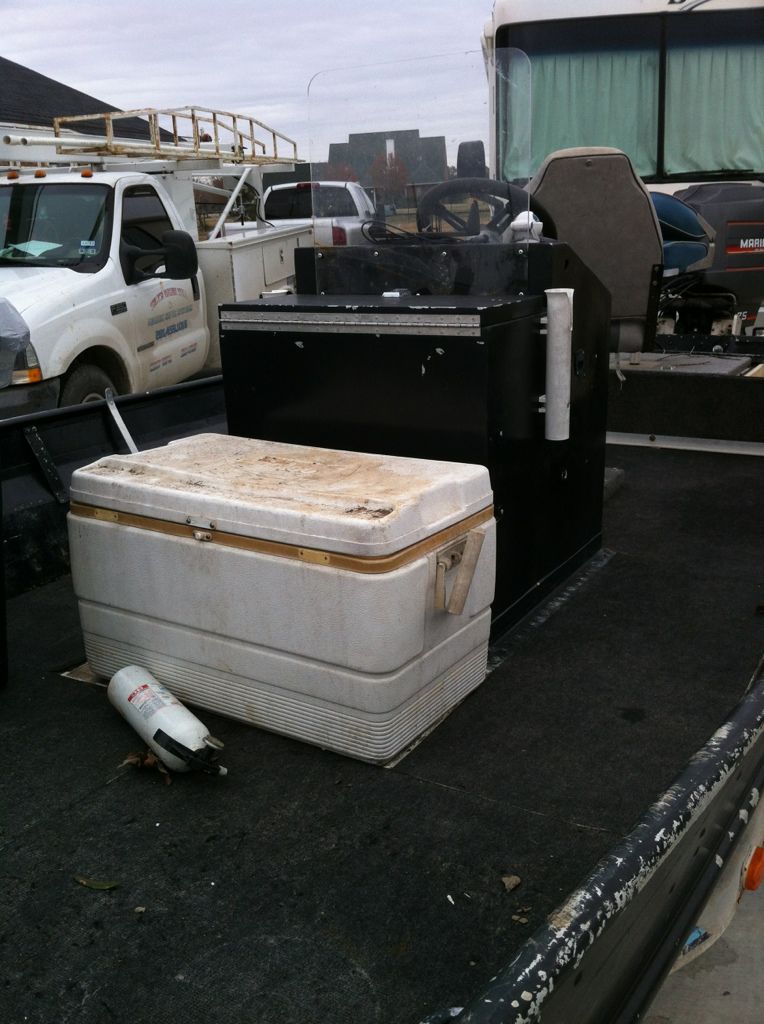

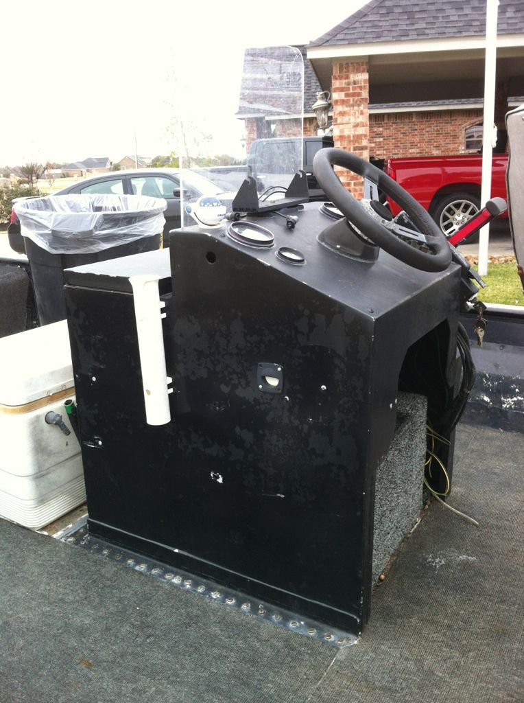

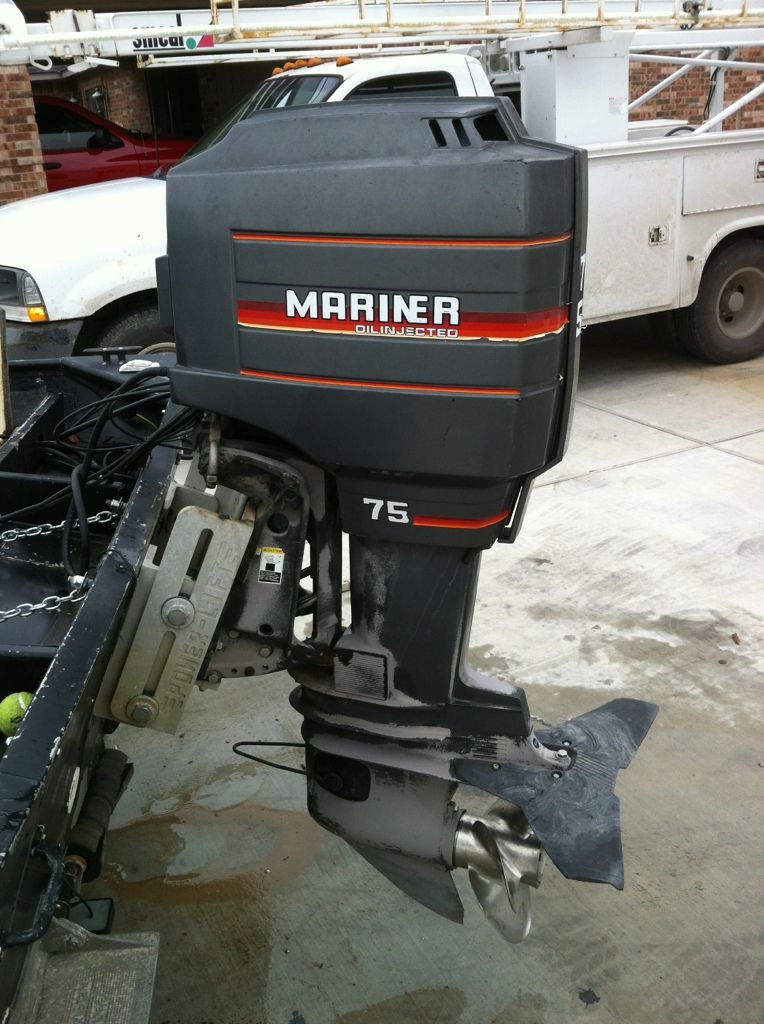

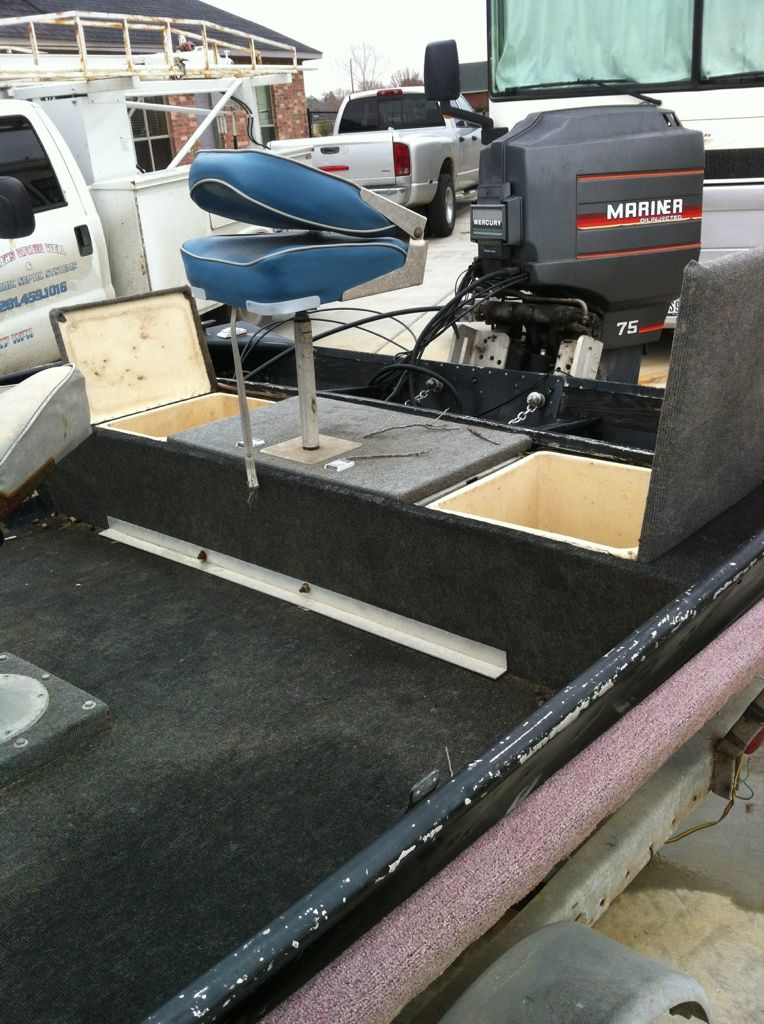

Here's the boat a few of you guys asked me to post. I had been looking for a big Jon boat like this for awhile and found a couple but the sellers kept giving me the runaround. I found this one a scooped it up pretty quick, it's a 18' mod v Jon boat it's 60"s wide at the bottom and 72" wide at the gunnels. It has an older 75hp mercury mariner on it that runs awesome and absolutely sails this boat, it does around 40mph. I plan on using this boat for flounder gigging during the colder months and for the rest of the year I'll be chasing redfish through the marsh and crappie through the bayou. It will also be a great bass fishing boat so in my mind it's a fishing machine! Here's pics

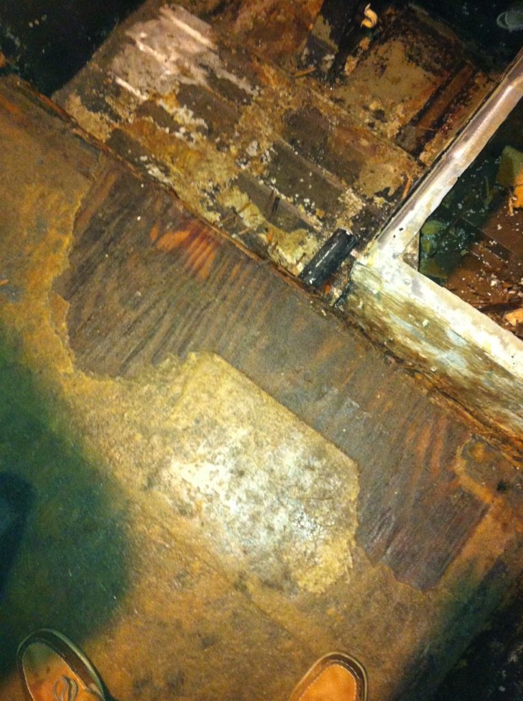

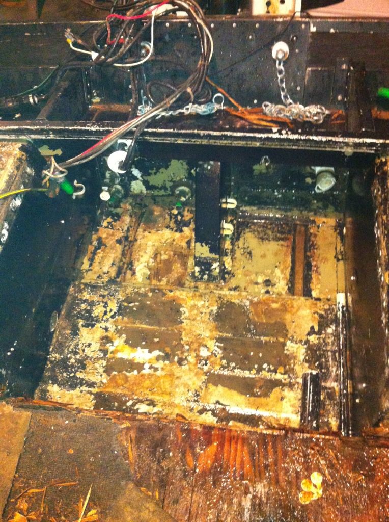

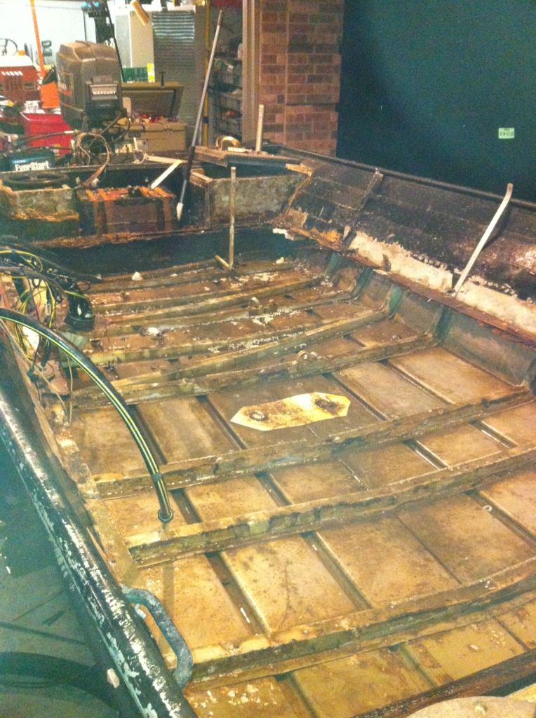

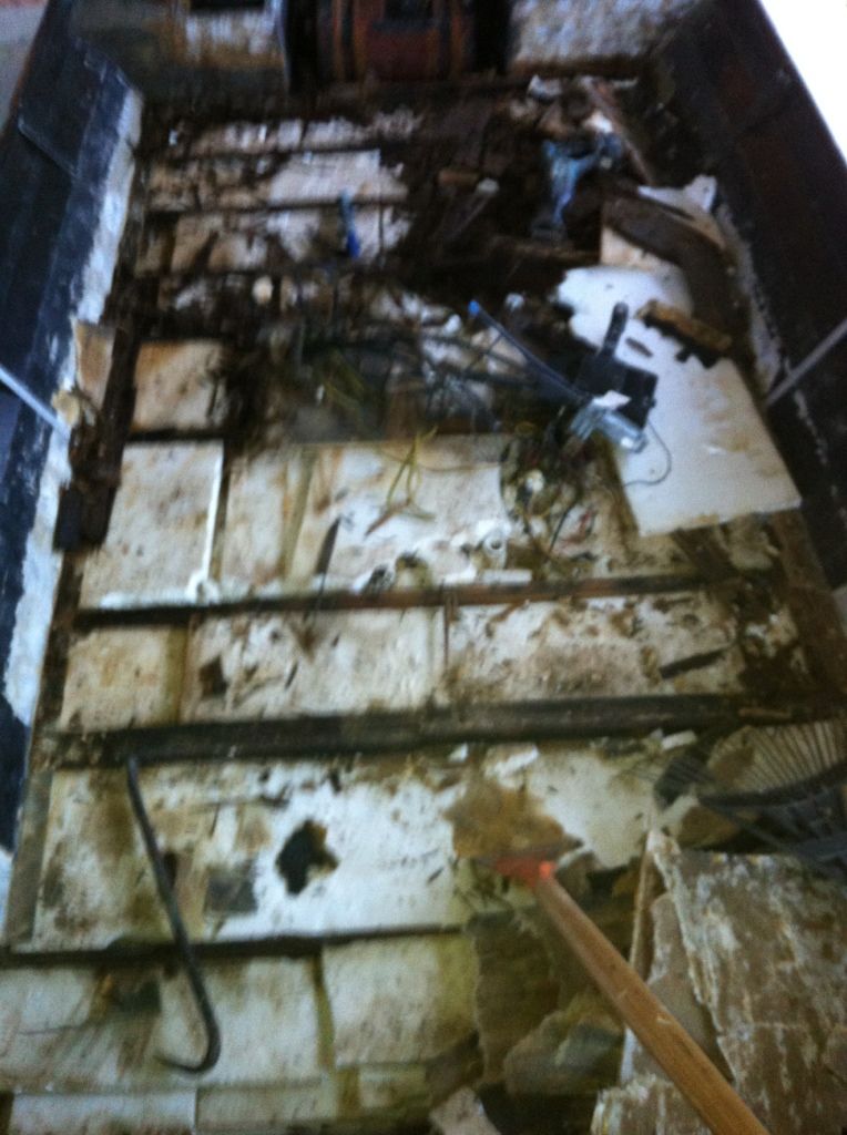

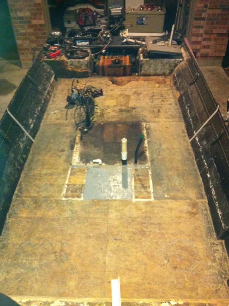

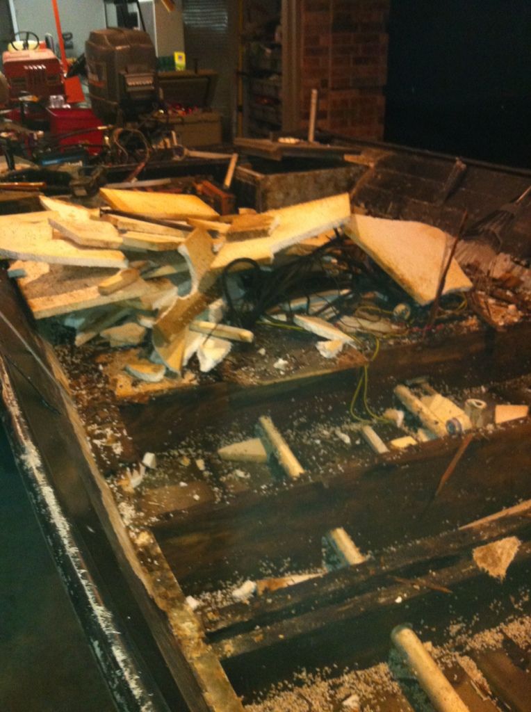

The floor felt solid but I suspected some rot because of it's age so I tore it out and went against a few people but I'm SOOOO glad I did. The reason the floor dident feel soft was because of the good bracing under it but it was shot no doubt. Out it came
The floor was fiberglassed on top
After a few good wacks with the hammer

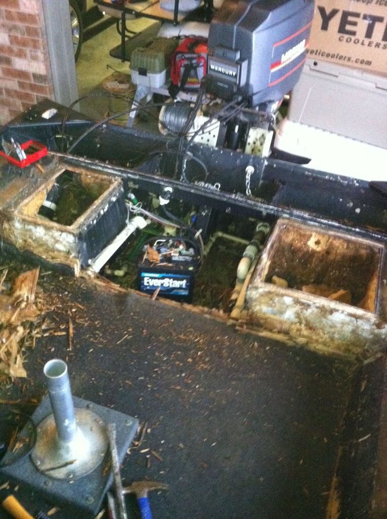

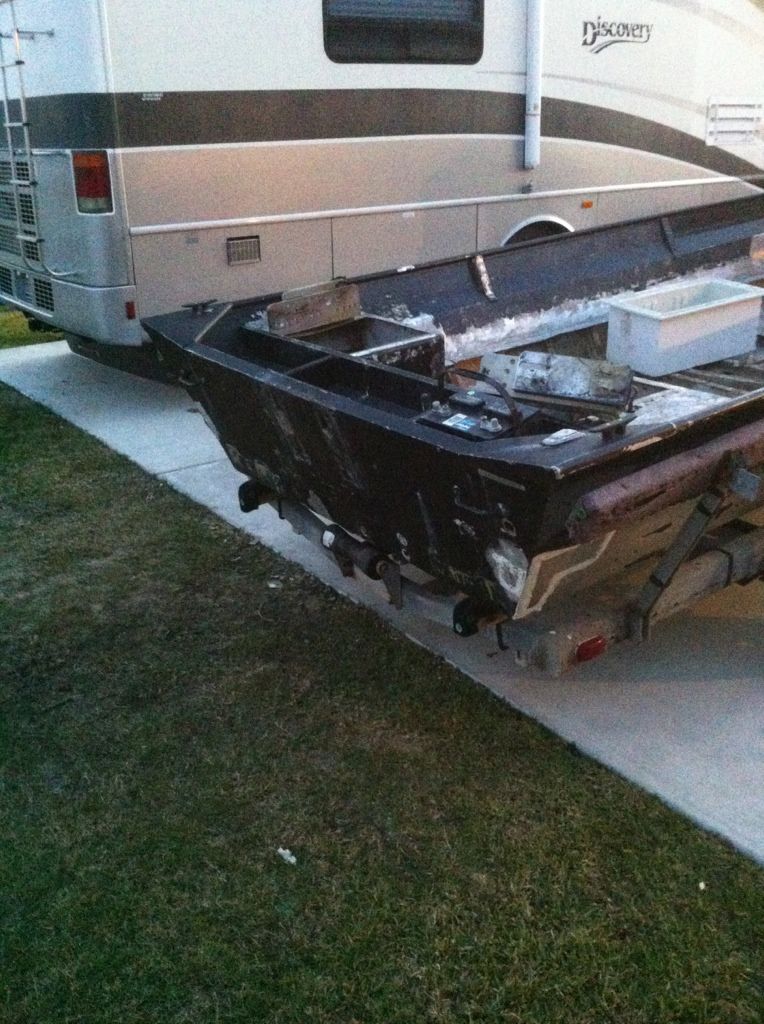

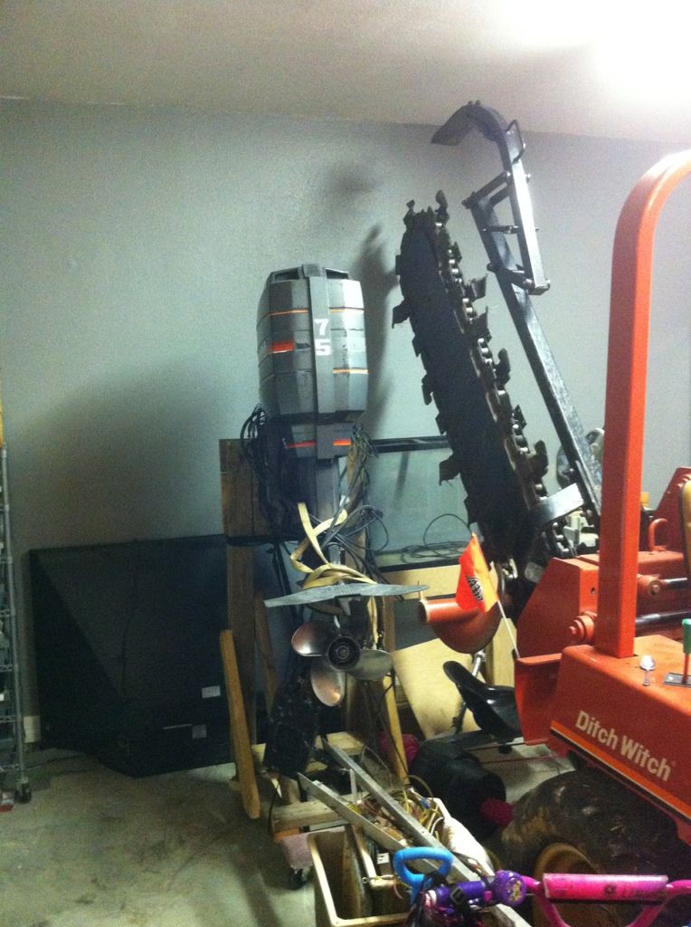

I built a motor stand out of some scrap wood I had and removed the engine

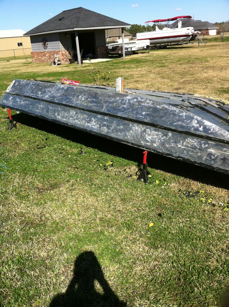

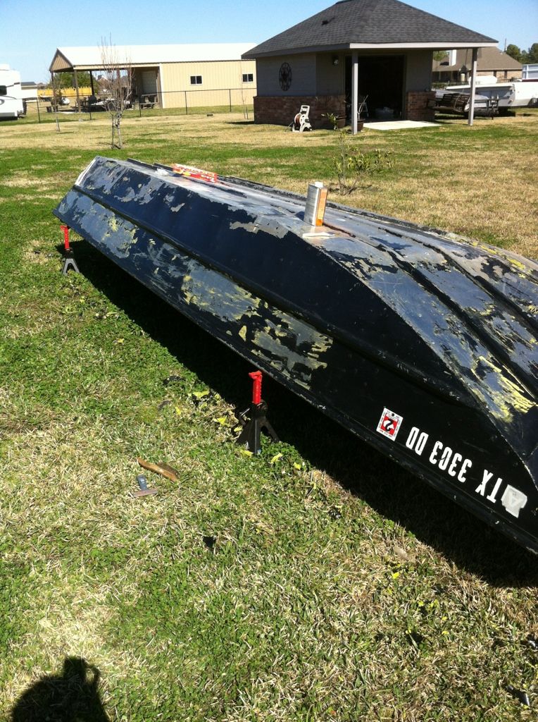

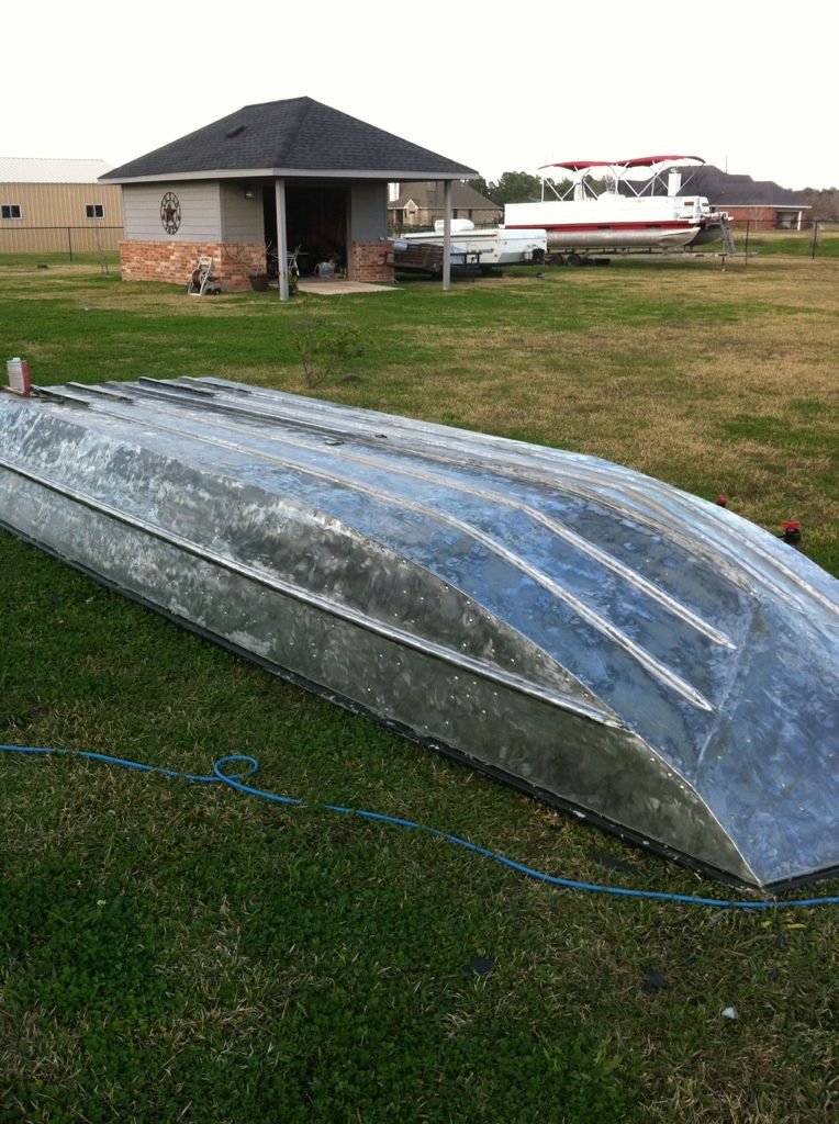

Then I took it off the trailer and began stripping the paint

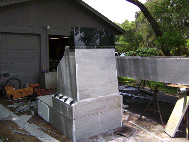

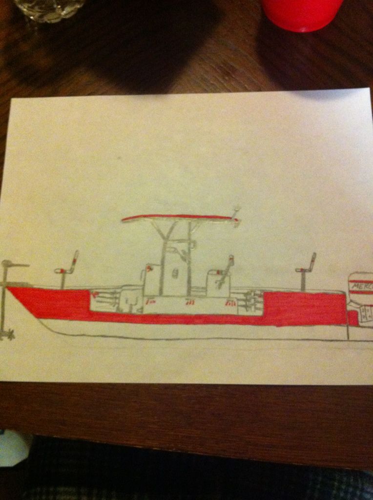

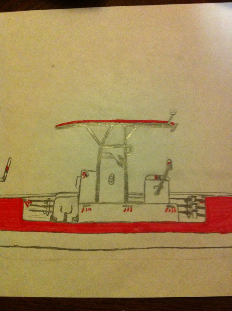

That's where I am for now, the boats about 90% stripped. When I finish I'm going to put it back on the trailer and fill it up with water to check for leaks, if I have and I'm going to fix them with the aluamweld rods. Then I'll tackle the transom, the wood is rotten in it also and I'm going to try and go back all aluminum. Here's a quick sketch of what I'm planning on doing

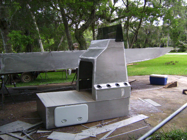

I found these pics on another site, this is what I'm wanting to do with the console stand

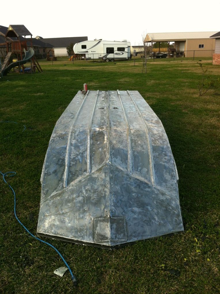

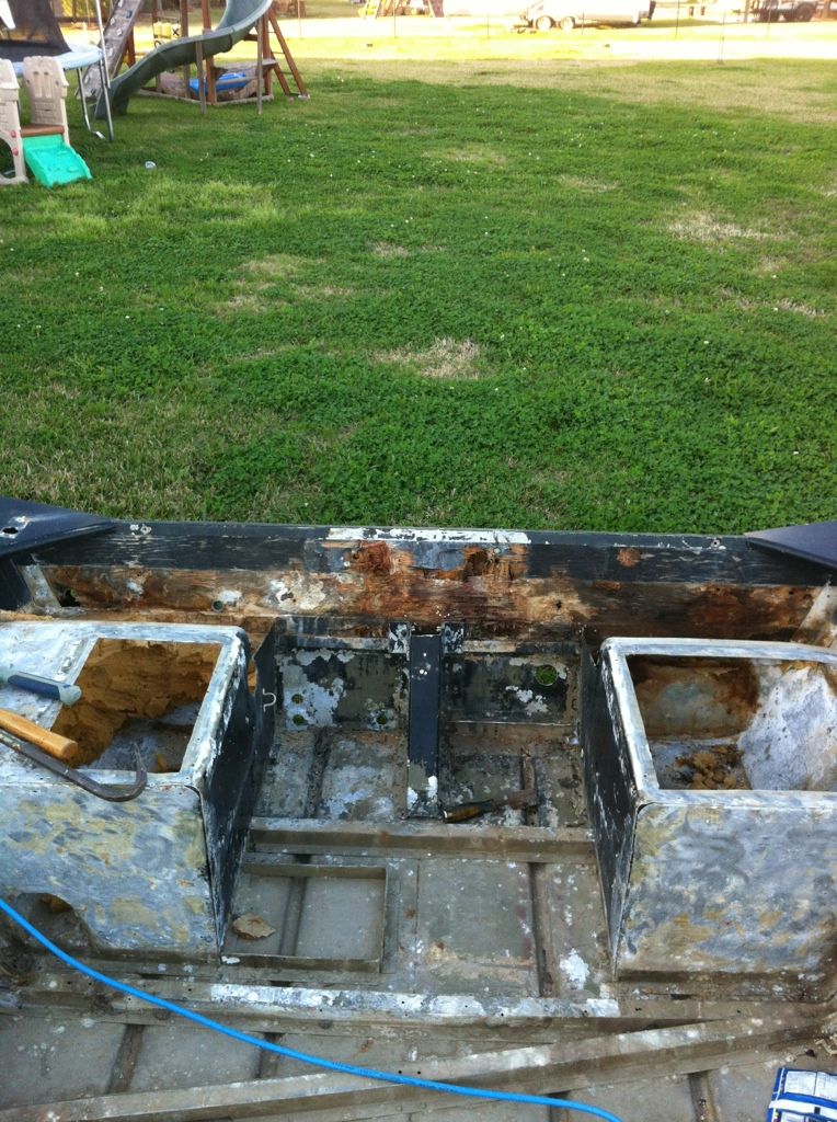

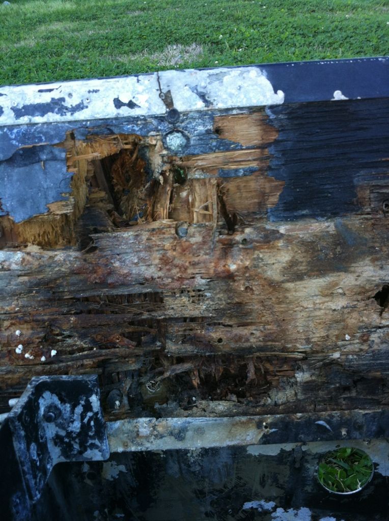

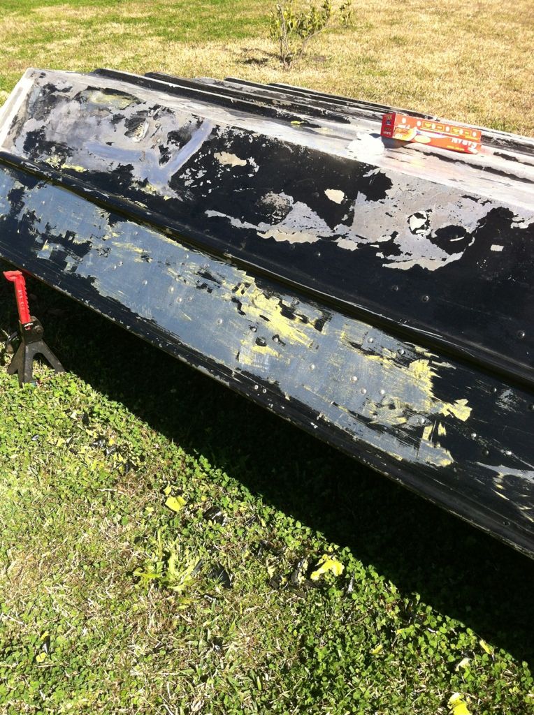

I worked almost all day on the boat, I got a lot of grunt work done. The whole bottom the transom and the bow are now 100% stripped

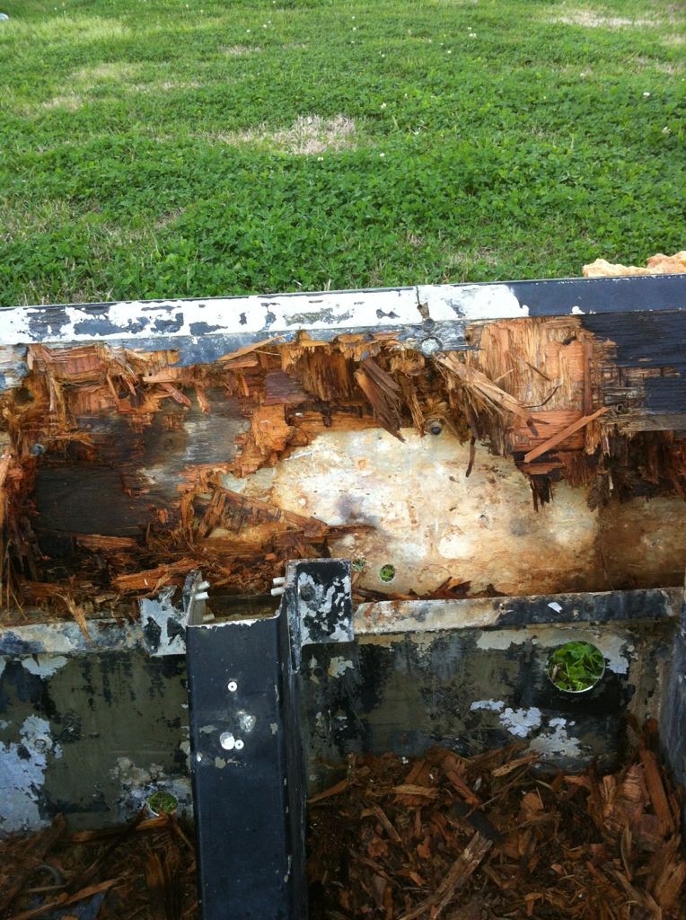

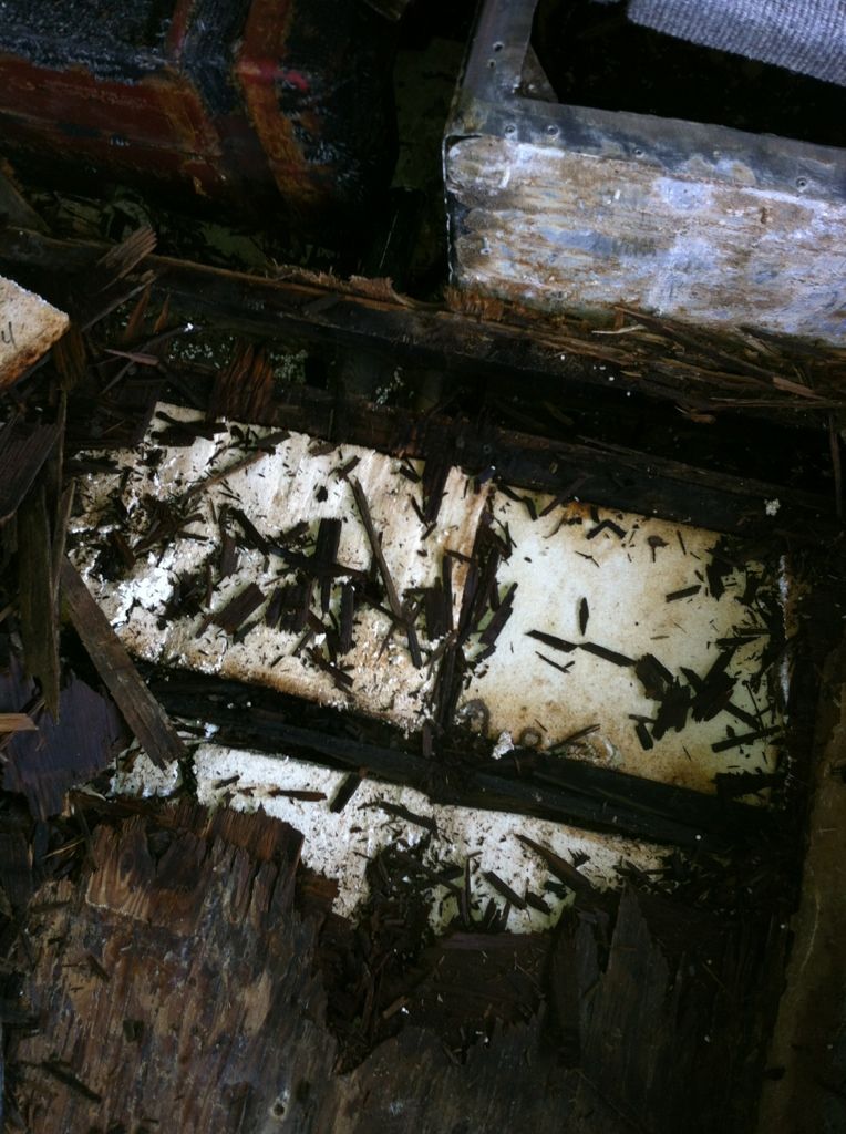

I flipped the boat back over and got to work on the transom, I drilled out a few rivits and I had the tray over the back off and I got a good look at the transom DANG that thing is in bad shape. The previous owner did a bad job at patching some small leaks and the water that got in just got between the wood and the aluminum and also in-between the foam in the rear compartments. This caused som savere corrosion, Ill admit I had a few thought run through my head like why did I buy this junk! Since I'm in it this deap I'm going to bite the bullet and fix it RIGHT! I pulled out about half of the transom wood with my fingers that's how rotten it is.
I coulda got about 10 more years outta that transom whatcha think....lol
2006 dodge ram quad cab

Re: 18' Lowe center console flat bottom rebuild
#14 Post by Texoma Toon » Sat Feb 09, 2013 4:24 am
WOW! That was bad! Looks like a redo of the whole transom. :thumbsup

#15 Post by Mrtoler » Sat Feb 09, 2013 1:35 pm
Ya a new transom for sure, the only thing holding the wood together was the fiberglass it was wrapped in!
