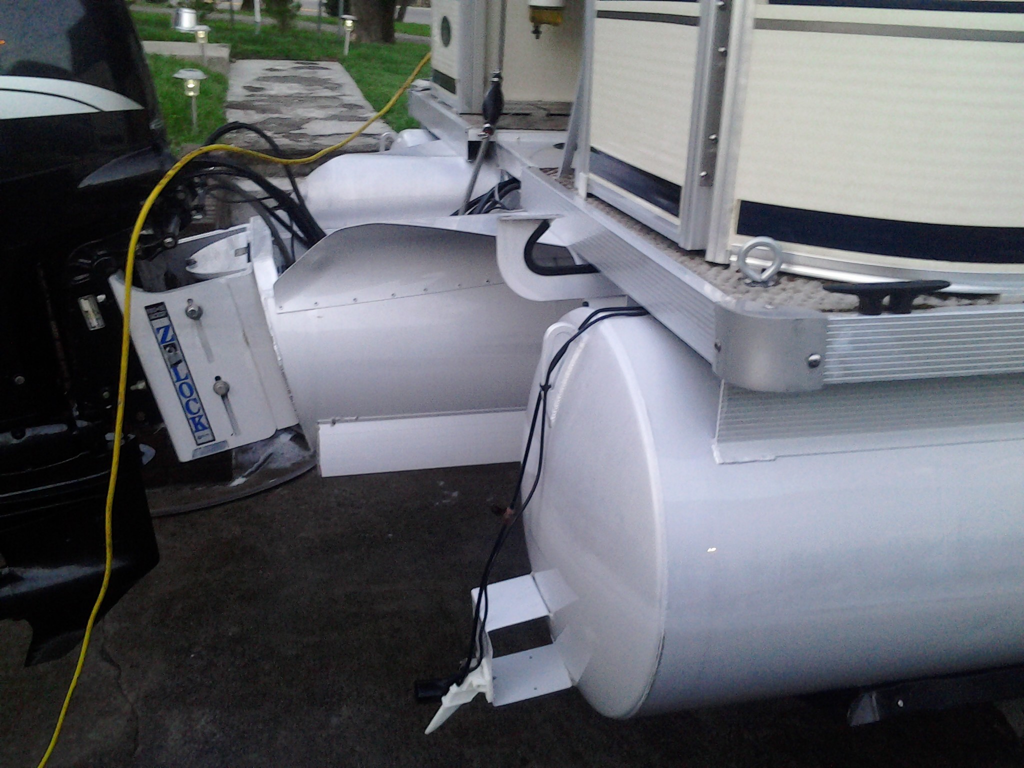

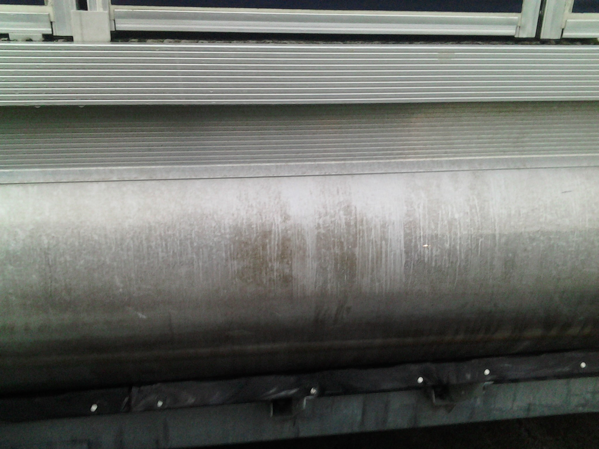

I found a pontoon cleaner, it's actually for all aluminum but it works great. Spray it on, wait a minute and hose it off. I couldn't believe it. I actually found the stuff at work and bought some to use at home because I was impressed. If you can like clean toons and don't like to polish'em this is for you. I included before and after photos. P.S. wear gloves it has some pretty aggressive ingredients.

So what's it called? Looks good.

Looks great, NAPA stuff's been lauded on the forum fairly heavily. Great to see more pics though!

It makes your boat look HUGE!!! :rofl
