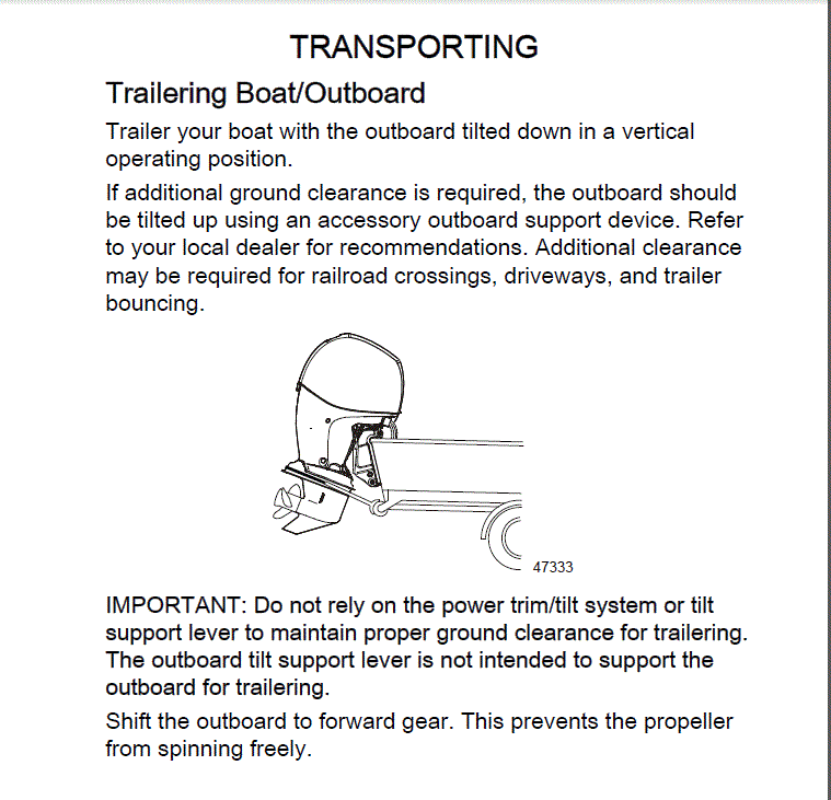

As long as ground clearance isn't a problem it's often recommended to trailer the motor in operational position. That's how it was recommended on my past Honda, current Yamaha, and this straight from Mercury.
Trailering Boat-Outboard.gif (44.08 KiB) Viewed 5387 times
Image Source

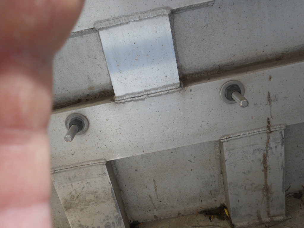

#12 Post by Bryden24shp » Thu Jun 27, 2013 12:25 pm
Really? If you do as much towing as I do, you'll end up with this. And you don't want this! Use a transom saver!
529ez 001.jpg (280.68 KiB) Viewed 5131 times
