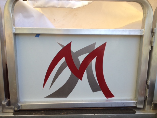

Its the stuff used for vinyl cutters to make signs.guy48065 wrote:Do you mean the adhesive-backed shelf liner stuff? Cut & stick? How did you get it between the railings without wrinkles? I can't even cover a flat shelf without that stuff grabbing itself or trapping air pockets...blackberg wrote:I put vinyl onmine,
The same sticker material, and then put the cut graphics on top.
Stripped the old graphics and sanded before hand
-bb
It comes in 24" and 12" wide rolls usually.
Some sections we removed the panels off the rails,(the straight sides), others we did them in place with the rails off the boat. then we put the graphics on top, also made out of vinyl.
The pic attached is the front door, that light gray vinyl for that panel was done off the rail since we extended the door all the way to the bottom.
-bb
