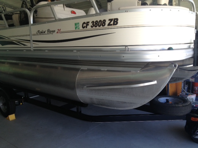

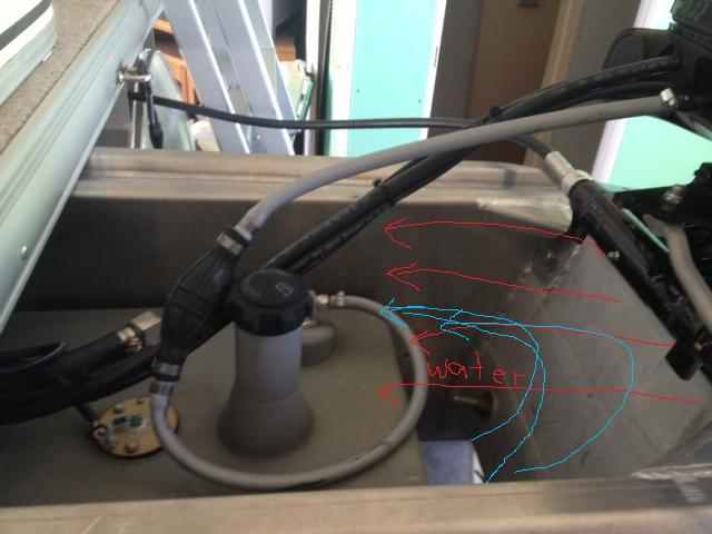

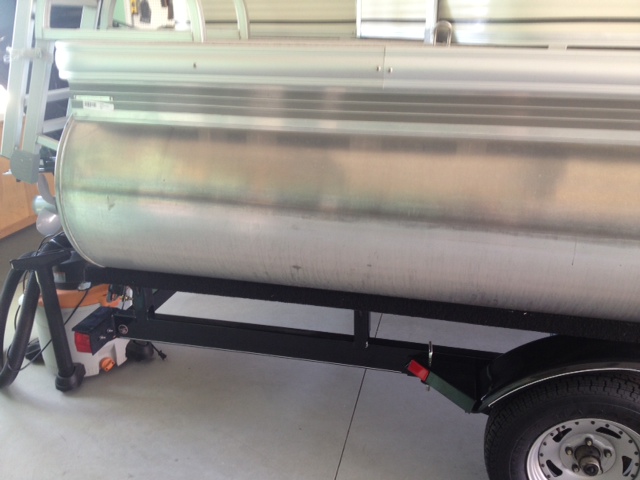

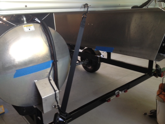

let me be a little more specific....
water line is about 1/2 way up pontoons in rear and a little less at bow. The engine pod/fuel tank pod, as designed, has the bottom of the fuel tank below water line (about 1/4 up the tank is under water (at idle). So nothing on top of tank is under water at idle.
When motoring, water is streaming forward from where engine bolts to transom to top of fule tank. It is rushing a pretty good blanket of water and pushing straight forward on top of tank. This is what I mean by everything is under water. When this streaming blanket of water is gushing forward, the vent hose, fuel pick up, and tank sending unit are under water. The fuel tank cap is not under this blanket of water; the water is about 2-3 inches above top of tan. The water gushing forward will only stop when reducing speed to almost idle.
I have attached pics to rule out if my boat is sitting to low and indicated where water is gushing forward.
1. In one of the pics, the blue tape indicates water line at TOP of tape.
2. In another pic I added blue drawing lines to indicate where I believe the water is coming from....it is being pushed up from bottom, as boat is running, hits transom plate and is pushed forward ( This is what I think)?
I, too, like the idea of the fuel tank weight down low.
Thoughts????
Thoughts????
Thanks!

Re: Suntracker fuel tank design/placement Problem??
I have a 2012 20 footer, and under full power I have at least a 1/2" sheet of water running over the top of the tank. I've had a water leak into the tank from the day I bought it.
End of the season I'm going to have to pull the tank out and reseal all the fittings. For the time being a 12 gallon tank on the back deck has saved the season.
I'd say you've got a normal water line, both front and back, assuming you've got at least 1/2 tank of fuel in it. You might Google images of manufacturer's sales photos/brochures, taking note of where their logs have the water lines. Most are probably taken with 2 gallons of gas in them thoughSoCalAngler wrote:Not quite sure I understand pressurized in this context. If pressurized, what about the vent hose connection at tank, the fuel line connection, etc? All of these hoses and fittings can allow air/water into fuel tank if a sheet of water is running over them for several hours during the course of a day's outing.
Does my boat appear to have a correct water line?
You just don't want the logs getting more that 3/4+ submerged. I've got the rear left tank and it's approaching 3/4 and also don't like how it lists, especially with the majority of seating on the same side, so, I'm in process on getting quotes on a center log to help with the lift. I also have taken water over the bow when 4 people are sitting in the short bench seats up front, which the full center log should help give some additional lift there too.
That tank location would make me nervous as a lot of water splashes around there, especially once you hit 18 mph. Though I do see how it would free up living space. Keep an eye on the sending unit gasket as the boat gets older. I replaced the gasket on my 20 yr old boat and it was pretty cracked, but no signs of leaking yet.
