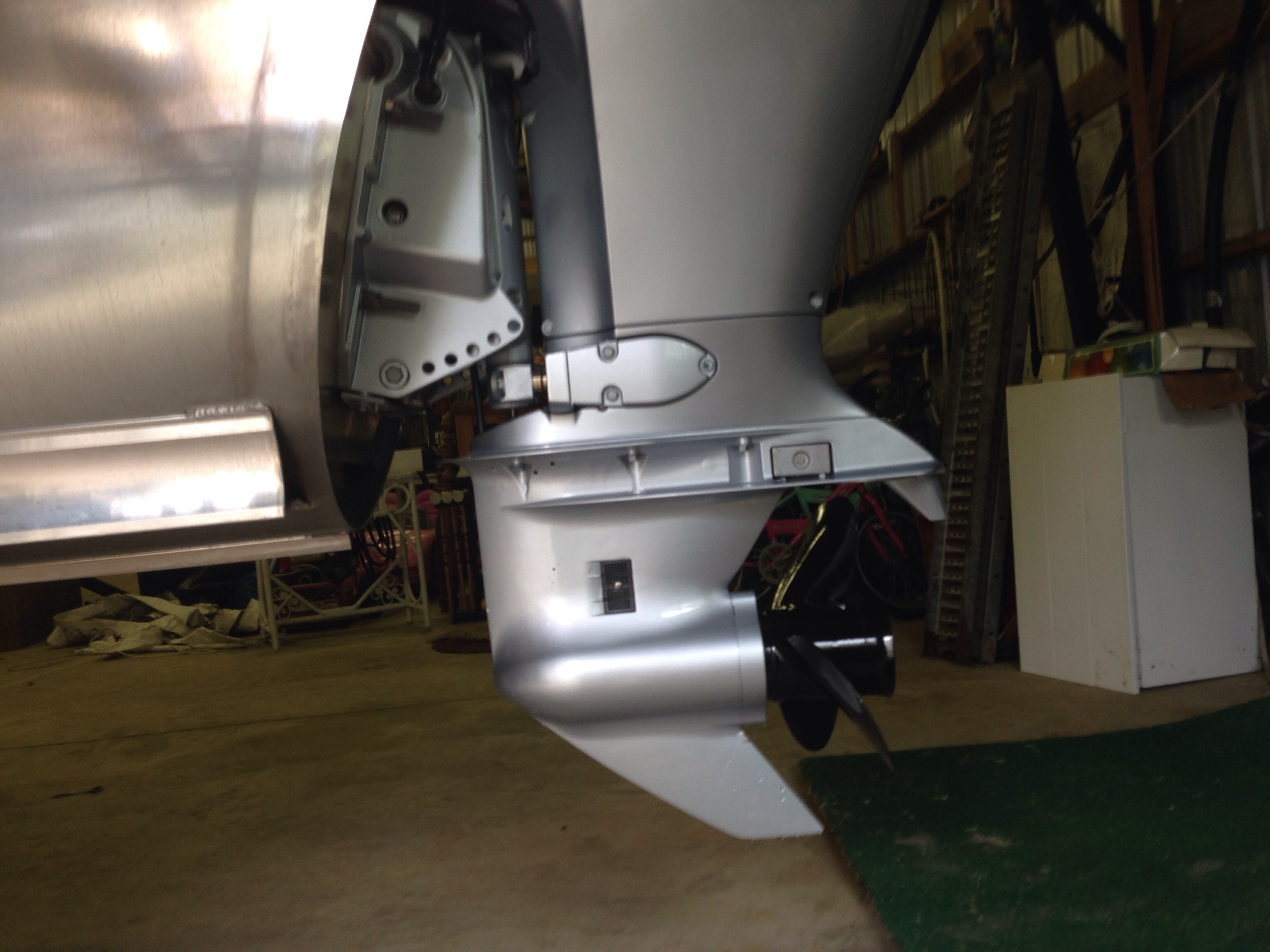

Just purchased 2013 24' Avalon Windjammer tritoon with lifting strakes on inside and outside of all three 25" pontoons. Having cavitation issues at 4,000 or higher rpm.
Powered with 2014 Honda 150 hp 4-stroke. Dealer setup outboard with 15x17 aluminum prop. Engine mounted as low as possible. Do you think I need different prop size? Any thought or ideas?

Let us see some pictures of the rearend, you can even include some pic's of the boat
, and how do you have it loaded when it happens ?

Water was choppy, had 8 adults of average size 4 in front, 2 in middle seats, and 2 on rear loungers.
- image.jpg (1.22 MiB) Viewed 9090 times

I am by no means and expert and I am sure more people will chime in here but it is my limited experience and knowledge that the main "cavitation plate" on the outboard motor has to be level with the bottom most portion of the transom it is mounted on. Your engine looks a few to several inches too high. Your marina will have to figure a way out to get it lower. Looks like a jack plate is in order... Good luck and safe boating.

4 blade prop helps ventalation issues quite a bit. I've notice a lot of pontoon manufactures have gotten away from running strakes all the way back to motor on center pontoons also. I didn't have an issue with ventalation issue before I added strakes to my center pontoon but sure have them now! I've had to drop my motor all the way down on the transom and run a good stainless 3 blade or 4 blade aluminum to keep it from venting and it's still very trim sensitive. I can NOT run 3 blade aluminums anymore, I just blow them out past 4500rpm. My theory is that the negative angle of the strakes trap air and feed it directly to the prop, some of the better handling toons on the market have the strakes stop about 2' before the transom and/or have a notched transom on the back that acts like a setback plate.

From the looks of it the motor is set a little high. The cavitation plate should be set even with the bottom of the middle log.

Is it "New"? From here it looks like someone put a short shaft motor on a transom that needed a long shaft. A long shaft would have provided about an addition 5" in which you could have utilized a couple and still been in real good shape. With what you have now a anti-ventilation plate may be your only option to minimize the problem.
