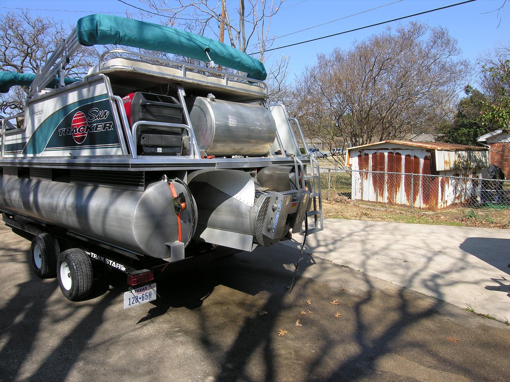

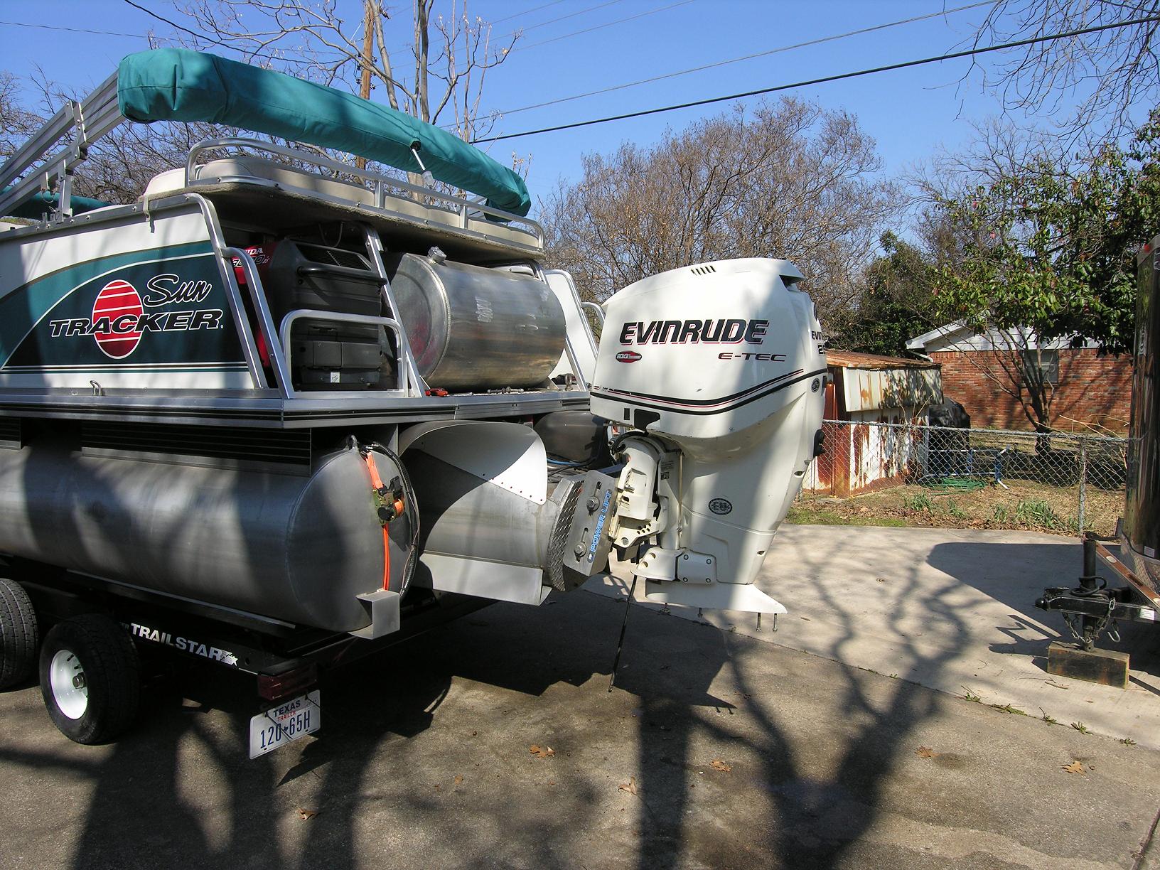

I have some pictures but I'm not to smart on the computer I can't figure out how to post pictures if you could help me I'd be happy to post a couple of them.
1997 Tracker Party Barge Pontoon
Converted to a Tritoon with a 2008 Etec 250
Cabinetman
- Posts: 16
- Joined: Mon Feb 10, 2014 2:54 pm
- Location: Arlington, TX
Re: ADDING THIRD TOON
I think I've figured it out I hope
- DSCN0466.JPG (436.28 KiB) Viewed 19834 times
- DSCN0462.JPG (475.62 KiB) Viewed 19833 times
That looks like it will work. With the gen set and big fuel tank you are ready to cruise. Let us know how the under skin works on the stern.
I've had the underskin for about 2 yrs. now and it works great it pushes most of the water out pass the motor.
Good to know. I realized after adding my center toon that that the water coming inbetween those tunes now is like a nozzle. I had to redo my steering and control cables beacause they almost got ripped off. Your "guards" look like a good idea.
