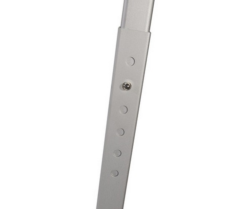

I wanted to somehow tie the tops together for strength and support. I wound up removing the front legs of the existing (rear) top, and attaching the rear legs of the new (front) top to those mounts. (see pictures). The legs were plenty long enough, but there was not enough adjustment available in the little snap-button adjusters to bridge the gap. These things:
I would up pulling the little springy 'button' thing out of the tube, and drilling another hole for it at the right location. In the end, the tubes wound up more or less horizontal between the two tops, at enough height that you can duck under when using the gate.
