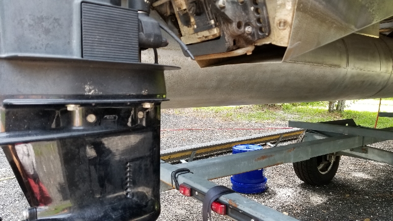

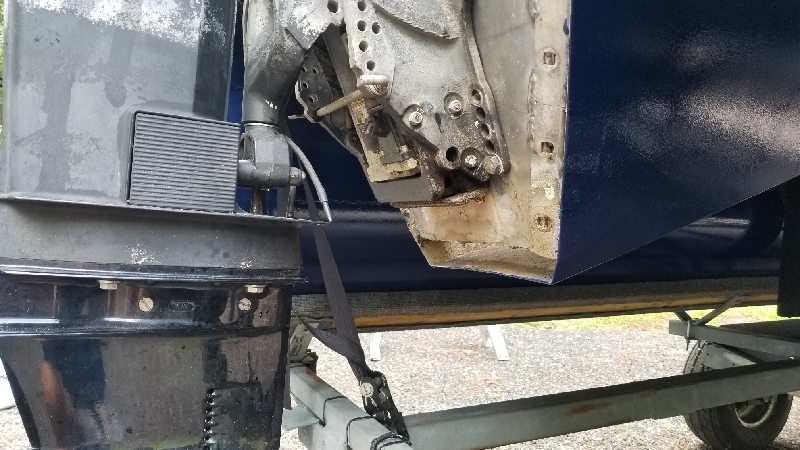

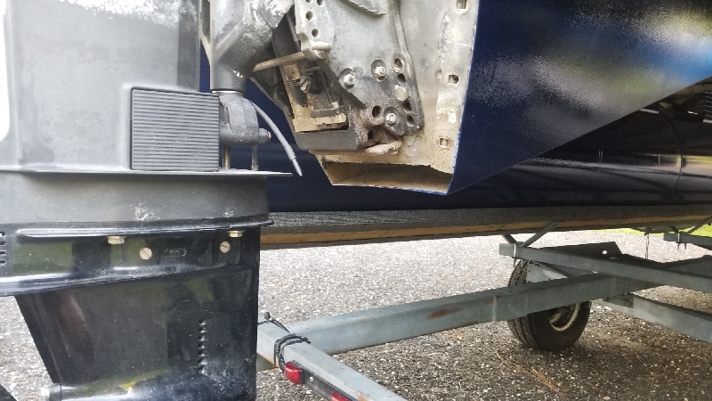

#2 Post by onlybillhere » Fri Jul 17, 2020 9:11 am
Here are some pics of where the motor was mounted compared to the transom...starting with the lowest and working up to the highest.

Re: Update on ventilation issue
#3 Post by wwind3 » Fri Jul 17, 2020 1:21 pm
Cavitation plate stiil way too low. Should be even or slightly lower than the motor pod on toon. I have a 90 Merc on a 20 ft Lowe and can trim mine up like a bass boat before it breaks loose. Top speed 27 GPS. @ 5800 rpm. Running 13x 16 pitch prop.

onlybillhere
Posts: 253
#4 Post by onlybillhere » Fri Jul 17, 2020 4:28 pm
I could go up another 2 holes and that's with me drilling out the transom and making new holes....and seeing if the steering cable can be at an angle. maybe i need to look for a short shaft motor....
