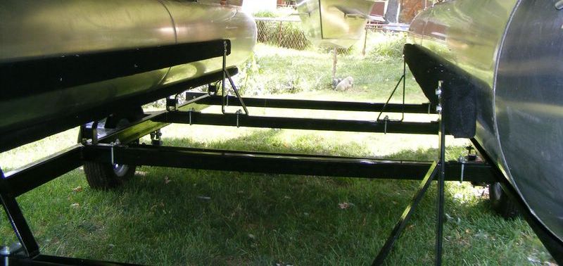

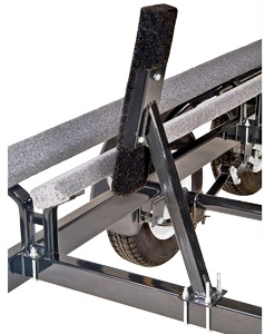

I trailered our boat extensively and visited a lot of different ramps, rivers, and lakes in our travels. And since ramps and conditions were always a new and sometimes eventful challenge depending on wind, river current, and ramp steepness and depth, we also sometimes had some of the same issues already discussed on this thread. Our first attempt to resolve the problem was purchasing these.
Pontoon Boat Guides.jpg (29.16 KiB) Viewed 6038 times
As a word of experience save your $$$$$, because they are tea-total-worthless in real world application.
Trailer Guides.JPG (71.85 KiB) Viewed 6036 times
The photo above shows a guide something similar to what we have now. I more or less made mine out of shear frustration and failure to find something made commercially. It's Not all that difficult to do at all and now I can back down and load the boat in any and "all conditions" as fast and easily as a jet flea. It works perfectly and takes all the apprehension out of the ramp experience.

Bamby, I really like the extended bunkers in that last pic, I may try to do something like that.
